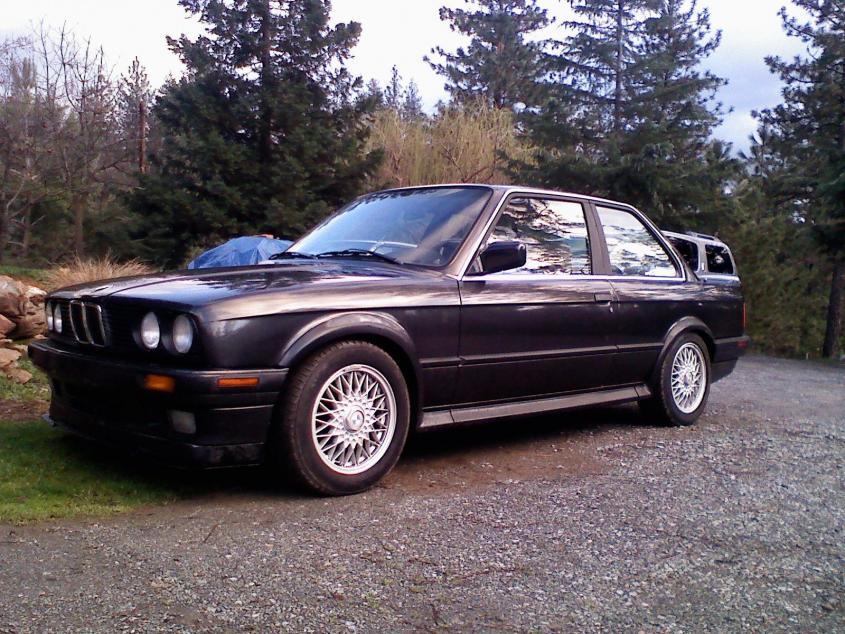

      Here's a pic of my most recent project...
      We don't like to quote rates as a standard. We prefer talking to the customer, and customizing the rates to their personal taste.
