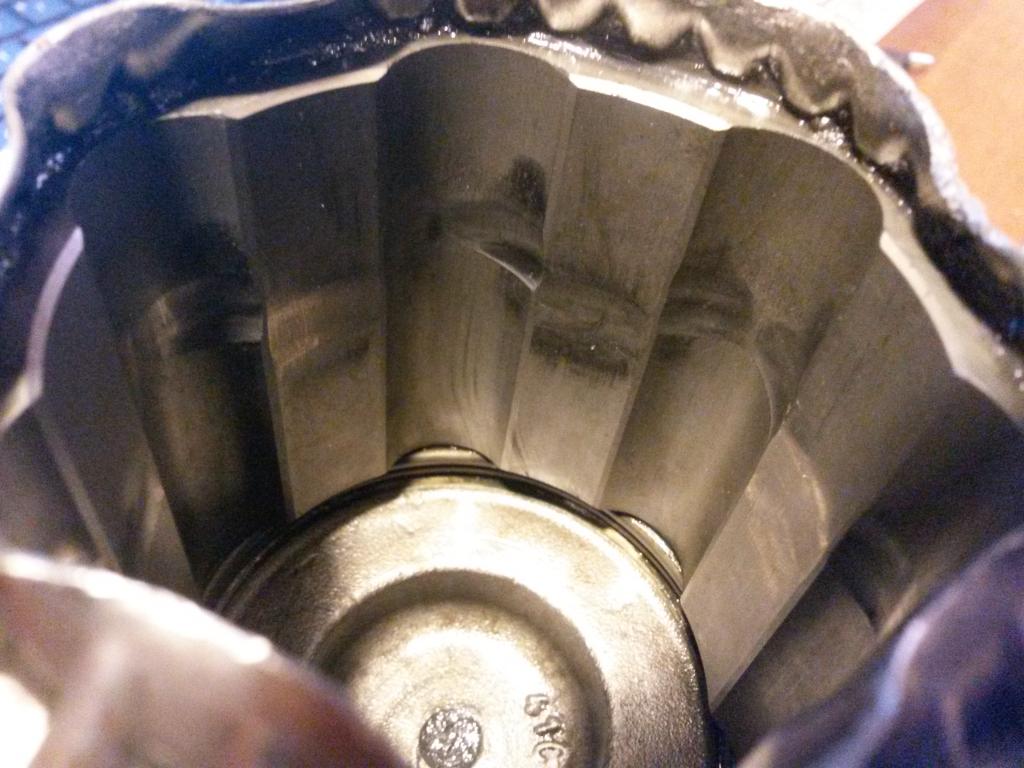

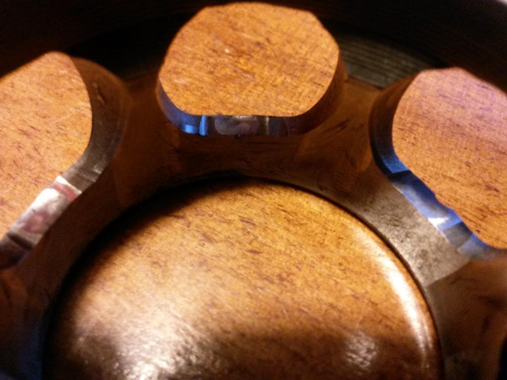

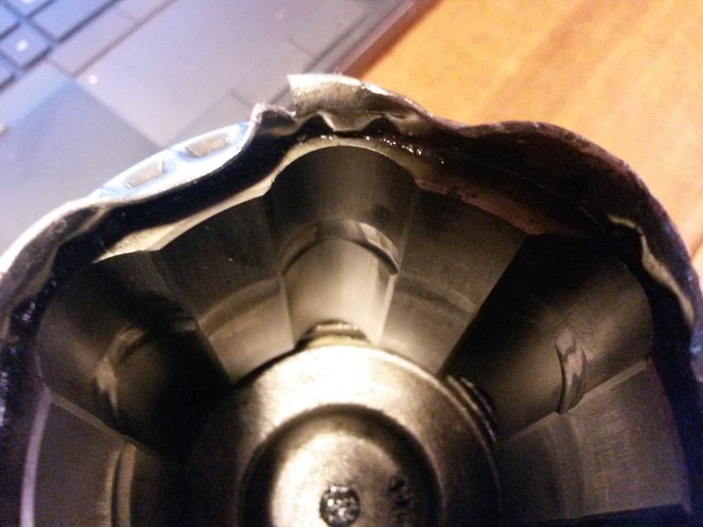

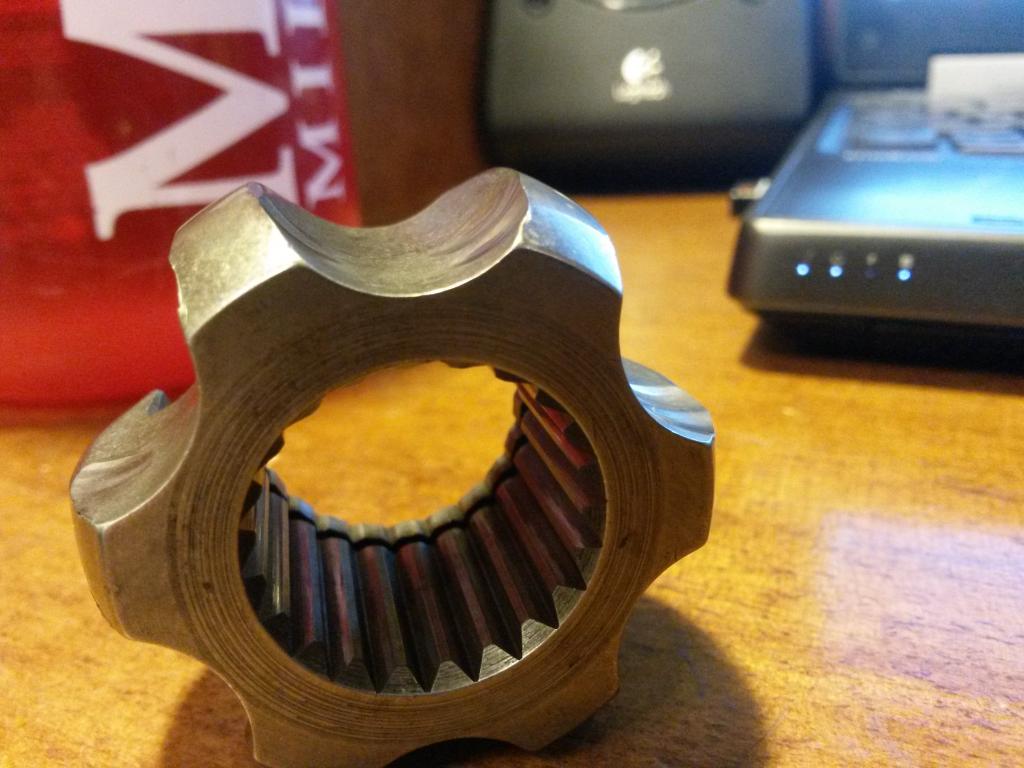

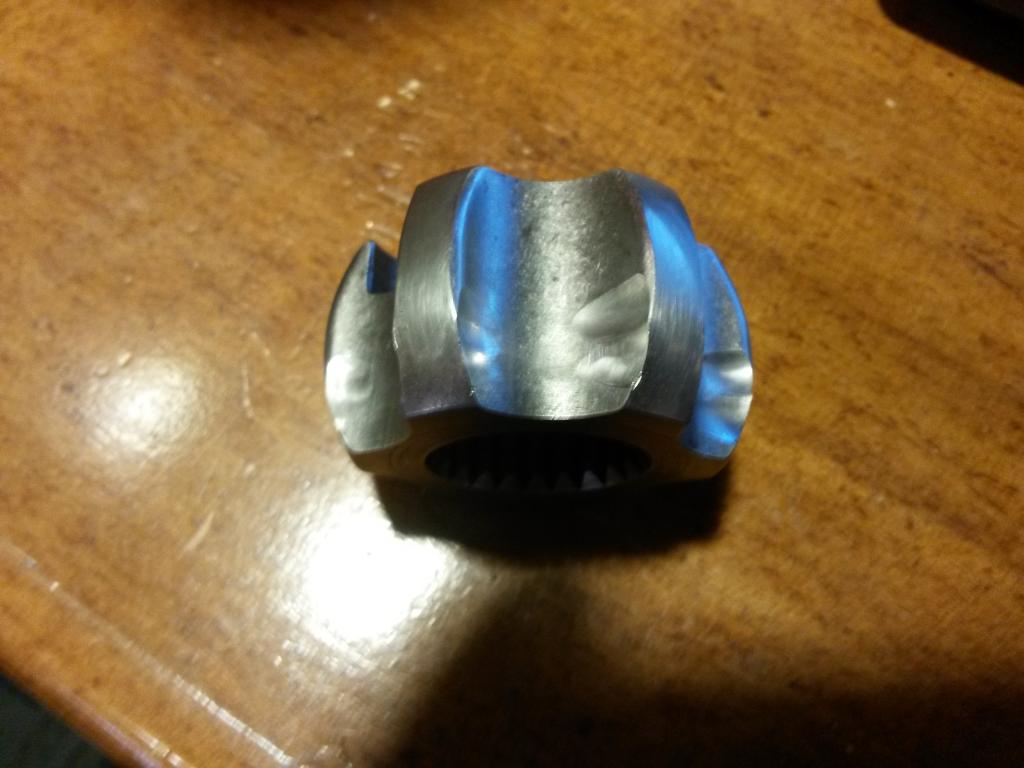

    So I'm rebuilding a spare set of front axles, the inner cv boot was ripped and the joint was full of sand and debris. I broke the joint apart and this is what the wear looks like. Do you think the joint is junk? Can you buy replacement parts for just the inner joint? The outer joint looks fine.

    Yeah, those are done.
    If they weren't handed, you could swap them left for right and get some additional mileage out of them... but they should be replaced.
      Yeah, I think I'll just save it. I have another spare set of axles, maybe that set will have a good inner and bad outer joint and I can make one good axle haha.
