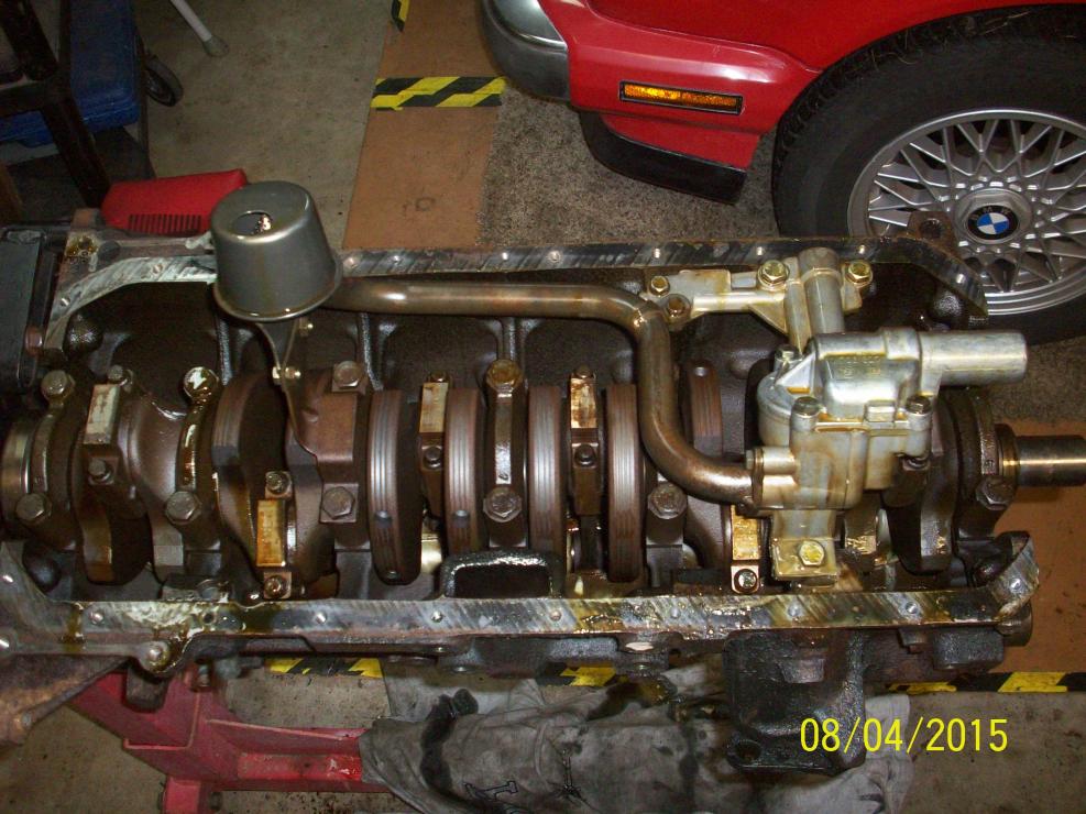

    Bottom end looks different than an e.. (obviously different pistons, different rods, layout of the oil pump, etc. ) - but it got me thinking

    Here a shot of the oil pump..

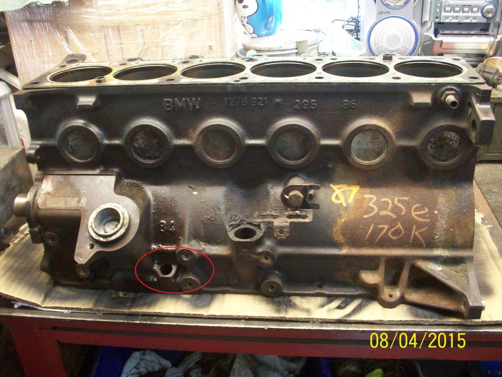

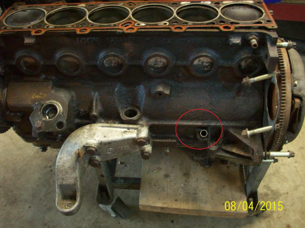

    location of the dipstick tube..
      vs "e"
        Na the ix block was made from a completely different cast
        It has a different dipstick location and the oil pump is installed backwards compared to other m20s, it even spins in the opposite direction
        For the most part people say you can't use anything other than an ix block because of the dipstick and oil pump but a few months ago someone was able to make it work (not very well documented but it can be done) the thread is somewhere in the ix section but not much info
        I do think all everything else is the same, including crank and pistons and defenetly the top end
