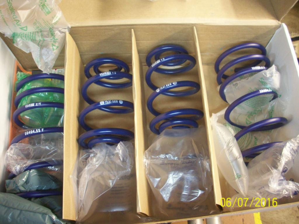

    started a topic IX Suspension Upgrade.. More Problems.. More $$
    Son is home from college and I thought I would invest in a suspension upgrade on the IX. I decided to go with the Bilstein HD and the H&R Sport (for the IX). Dont judge me Nando..
    Got the Springs..
