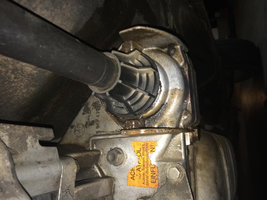

          Ok let me get it up in the air. How can I tell if it's a output seal leaking on the front driveshaft end? Fluids getting flung up on the tunnel and some under the DS floor pan. I'll try and get some pictures uploaded.

            If its getting flung it a good possibility it's a driveshaft doing the flinging. You can pull the plastic protection cone back on the front shaft and look at seals. Maybe clean the area and run it to see if leaking. Rear shaft output seal usually just leaks down back of case

              Yeah it's certainly leaking from that seal. Apparently the atf removes undercoating pretty easy too

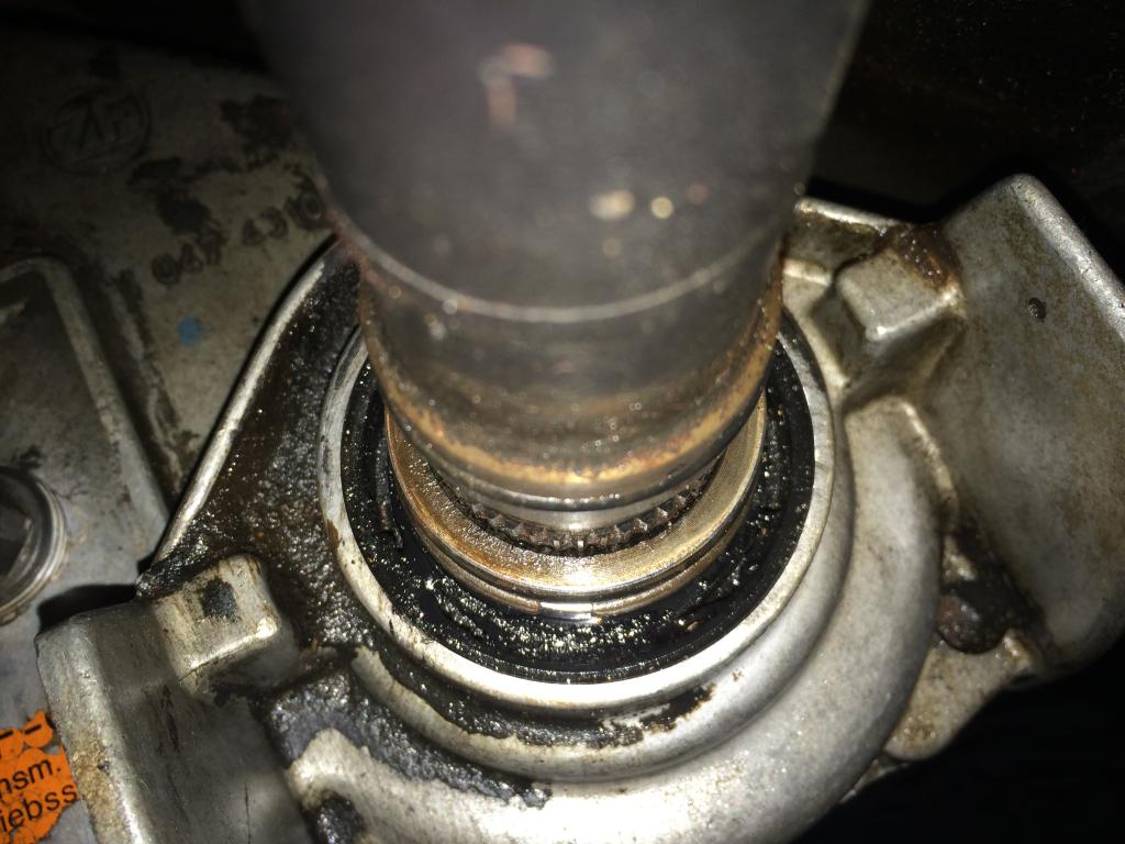

                Here's one with the cover off. I thought it was the intermediate seal between the cases at first but I guess not, any tips for the removal/ install besides removing driveshaft and the ATF. Lol

                  There are two seals there first is in backwards with the tension spring removed (its a dust shield) second is in normally and is the true seal. Be very carefull if removing with pick type tools so as not to scratch the sealing surface(I actually drove two sheetrock screws into the seals 180deg apart and used those to pull the seals out), also tape over the snap ring groove so as not to cut new seals when installing
                  Carefully measure seal depths to be sure new seals are installed at same depth.
                  Install carefully/squarely with deep socket.

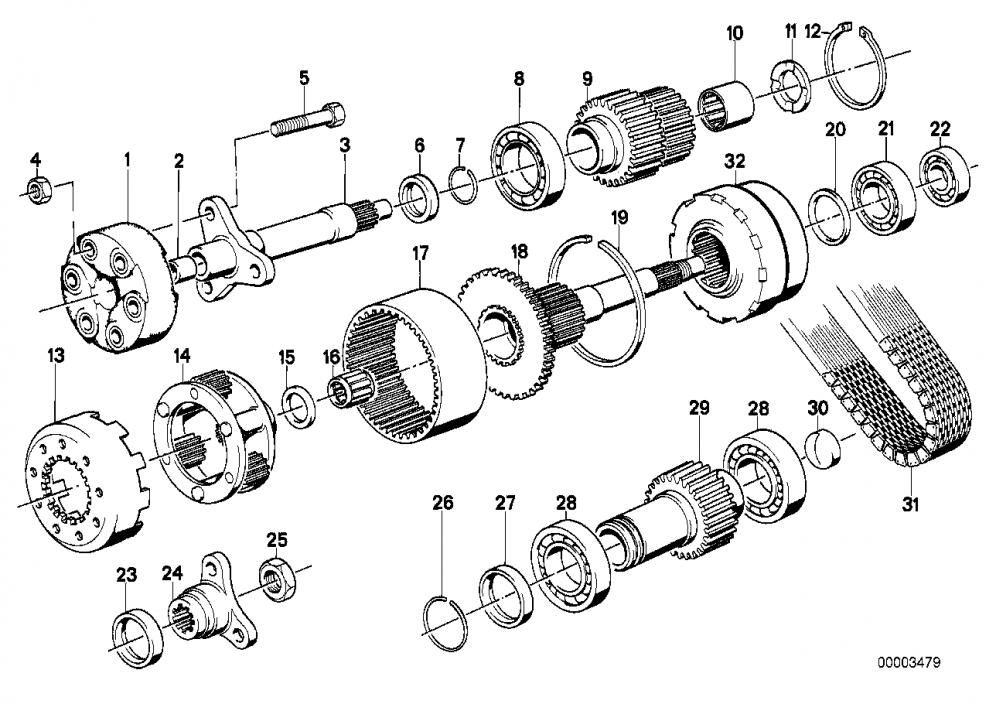

                    27211224632 #6 on real oem. Looks like the right part.
                    This is the seal part #?

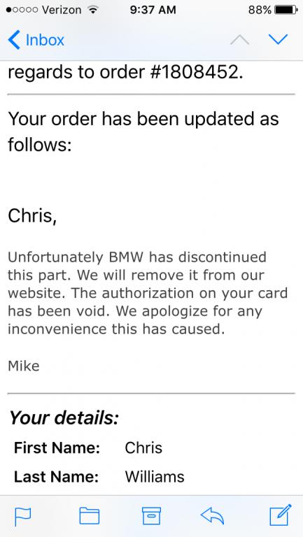

                            Ok, I ordered two from BMW South Atlanta and they sent me this. Ecs even says its NLA, turnermotorsport says its Backordered..

                              #27 is the part you want two of. #6 is the rear driveshaft output seal
