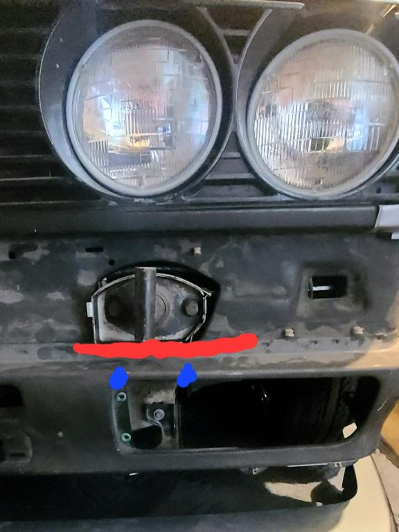

    I am looking to install a late model front valance onto my diving board 1986 325 coupe but did not want to chop off my tow hooks.
    Has anyone successfully installed a late model valance and retained the front tow hooks by notching the valance before?
    Thanks in advance.

    Im in the middle of the job as well. Theres no way. Youll habe to mess with the valanc.
    The hooks are right below the bumper shocks. See bue dots.
    The red line is the valance pushing up against the bottom of the shock.
