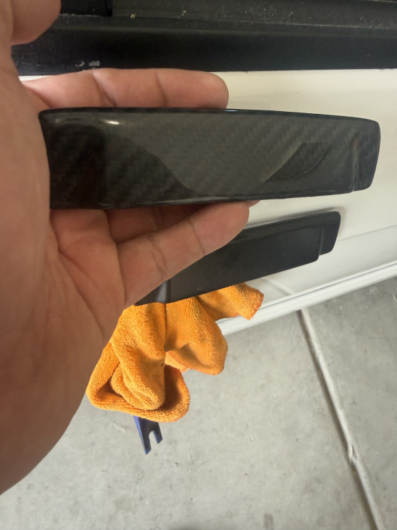

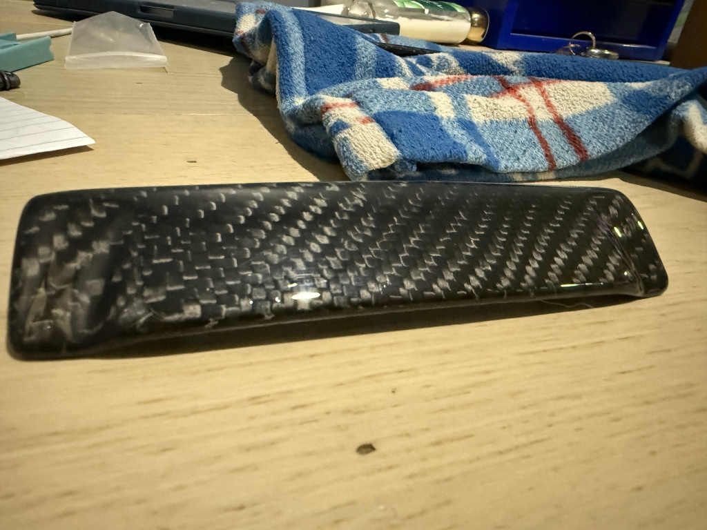

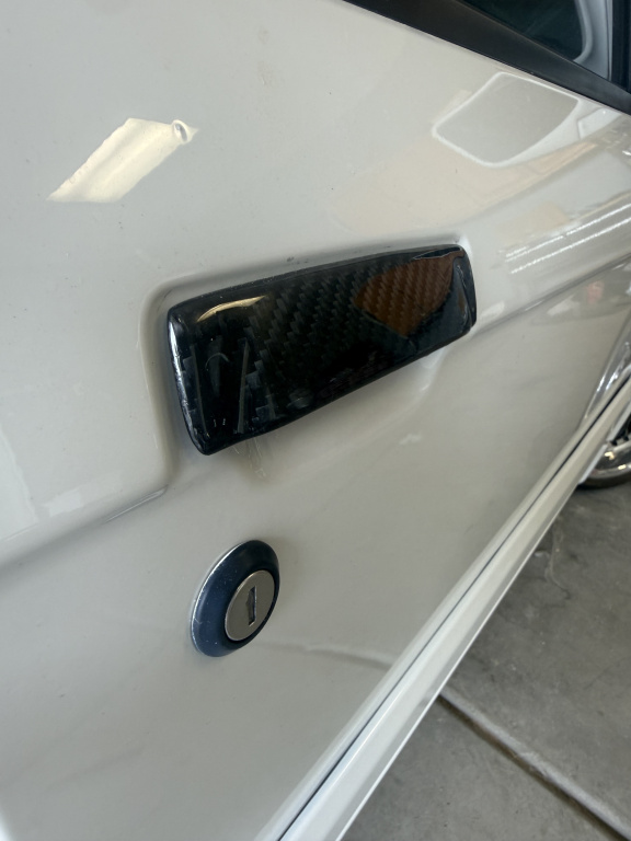

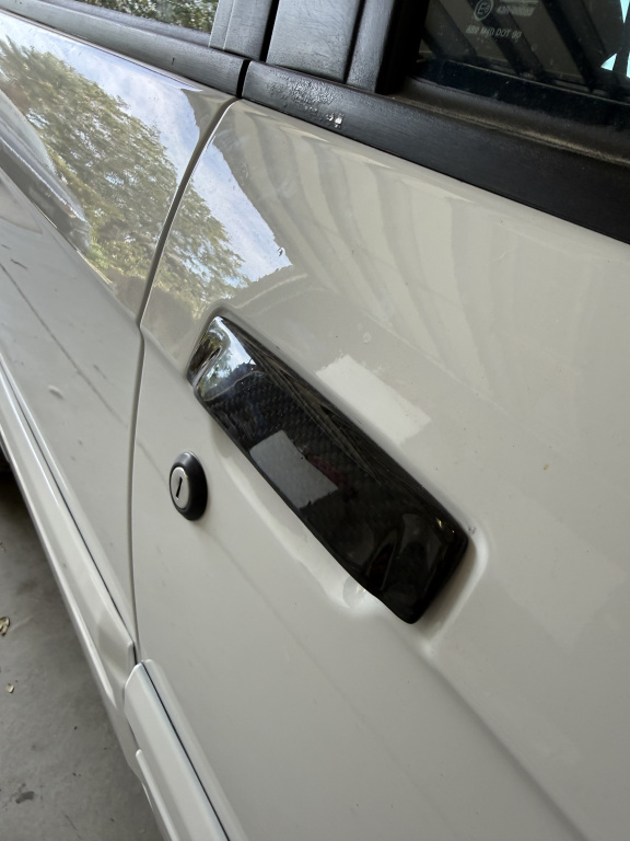

    So to start these are kinda pricey but I got them on Memorial Day sale I think 20% off garagistic . They do come matte carbon fiber and I had them cleared .

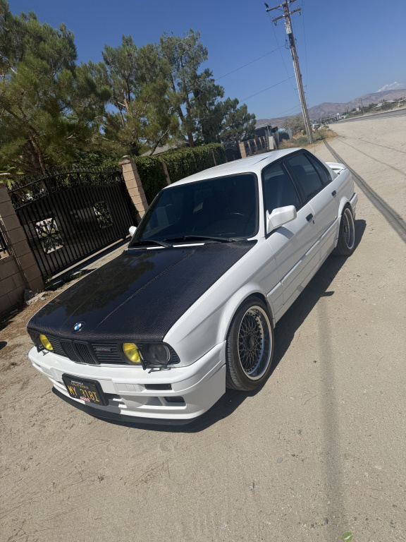

    My car does have a carbon fiber hood so I kind of had to have these

      The door handles look good and your e30. I have mine off one of my e30’s. Gargastic say are made of carbon fiber that weigh 35 grams. I weighed my factory aluminum door handle. It weighed at 39 grams. I might buy two sets for my project e30’s.
      What carbon fiber hood you have? I going to pull the trigger this week to order Karbonius carbon fiber hood that weighs 12lbs.

        Which manufacturer made your hood? Was the installation and fit?

          It was the VIS hood I was able to do a local cash pick up price that made it worthwhile . All the brackets line up with oem points . The hood shock was new on my car so it was hard to close because the weight difference so I put a used one in and fixed the problem
          thw fitment likes up well on the fenders and on the front along the grill . Towards the windshield the hood sits a bit low but I just added a washer on the little rollers and flushed it up .
