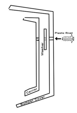

        I think there is around 5 rubber washers that "sandwich" between the carrier (#7) and the bumper cover (#1). They are held in place with the plastic rivets.
        Goes together like this:
