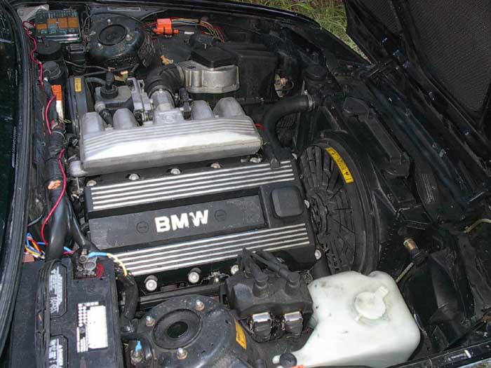

        so here is my engine bay. since the picture I have found the black palstic to cover the wires on firewall. that helped clean things up. the center cap I need to repaint, I did not at the time as I was gonna go with a cop kit, then $$ prioritys ( and laid off) sidelined that.
        blasted the valve cover, washed it, painted with engine black, then sanded down the ridges, when I do it again, Ill then hit it with clear, then the ridges would be easier to keep clean. ILl do it next time, as I have two v/c attaching bolts that are stripped, so when I fix those, Ill repaint the v/c and the plug cover
        Ive alsways liked the way black looked , and in my black bay it , for me , ws the best choice
        left teh maniflods "silver" or the engine bay would be too "black". adm with the v/c bolts. painted a few black , but liked the contrast, so I left them silver and wiped off the black ones
        ( note wrinkle finish needs curing in a oven at 200 degrees, wife killed me when I did that the last time on a car, stunk th ehouse and oven up for days)
        its a vert, thats why the batt is up front, the fan is a volvo 2 speed puller fan, wired directly to the bmw system so it keeps the 2 speed function, have it on a cooler set radiator switch

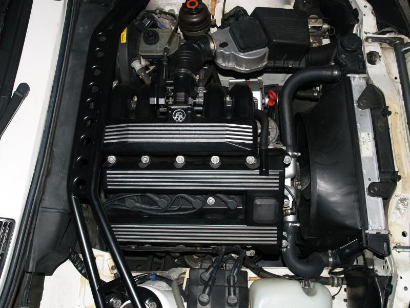

          found this over on M42club.com. It looks pretty good, making me sway more towards the black/black look. Of course it will be in an alpine white engine bay.

              ^^dude that looks pretty freakin good. From this i have definitely decided that i am going to paint the intake manifold black, but i still have not settled whether the valve cover should be red or black.
              How did you do it? did you sandblast and then paint? did you use primer? what kind of paint did you use?
              Thanks

                i just cleaned it really well and then used some scotch bright pad, masked what i didnt want painted. I then spayed self etch primer and then i sprayed high heat black paint.

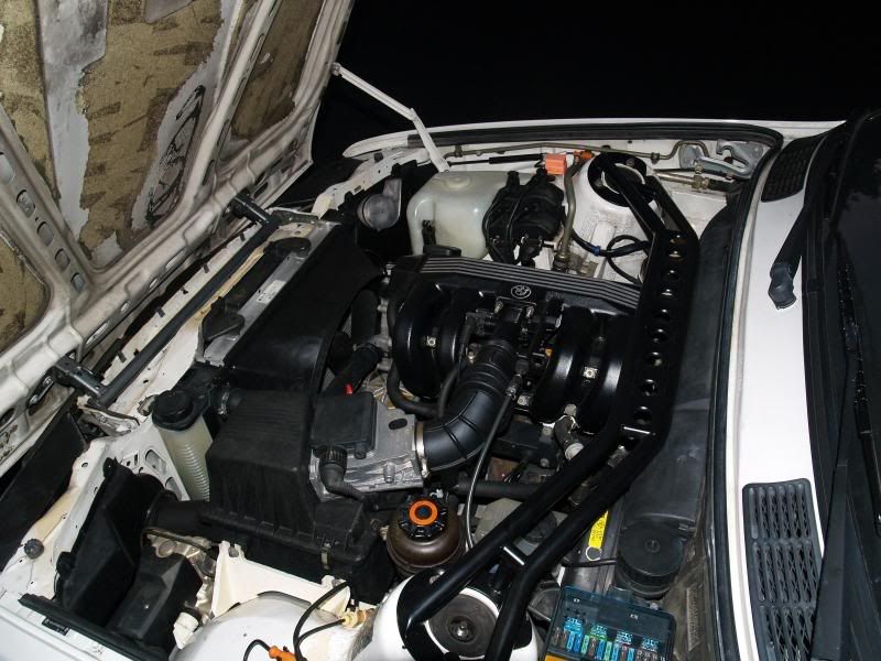

                          For some reason, I think red is the ticket in an alpine/white car – otherwise, black/black all the way.
                          I am in LOVE with how mine turned out.

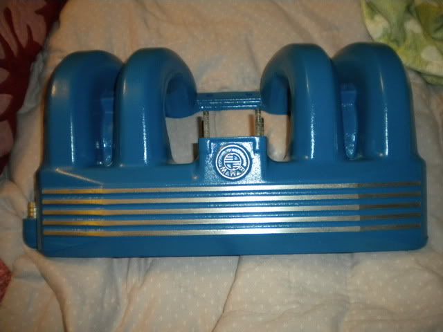

                              I got a hair up my butt to paint my Intake Manifold BMW blue while I had it off. While the idea still appeals to me, it's very blue... and on the Alpine I base/Alpine II top coat (sort of a really nice creamy white) it works. But again, it's very, very blue. I'm looking at a few different options at this point, as I have 2 more intakes sitting in the garage. Flame on!
                              All in all I wasn't disappointed... but the VC and TB need to be done in black I imagine.

                                hey, that looks good!
