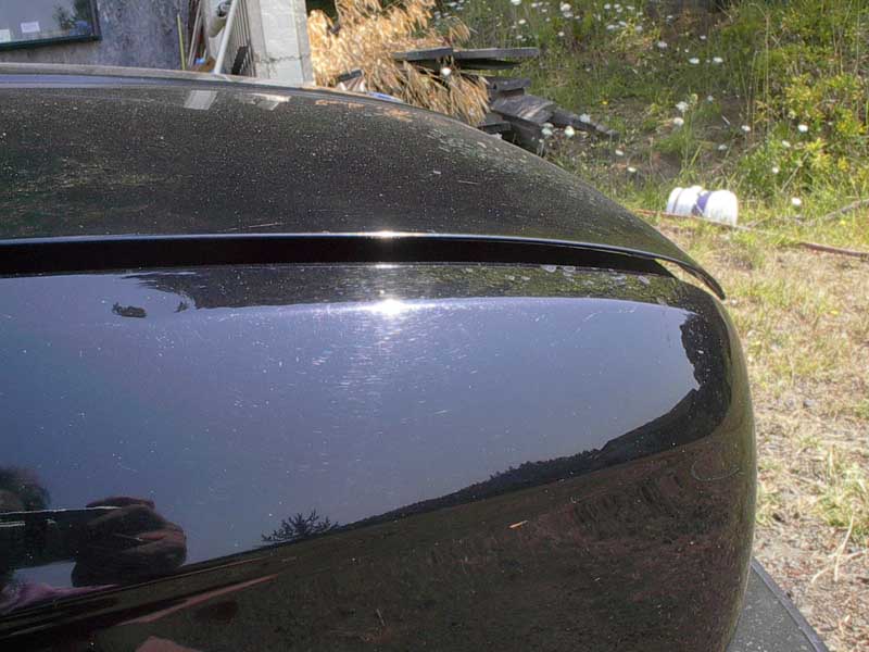

    so my vert has stickers that have matching seriel numbers on all removable body parts, fenders, doors trunk
    except the hood...... it only has a sticker that says "dot bmw" the car has a clean carfax
    my parts car is the same, mathcing numbrs and same sticker "dot bmw" on hood but it is known to have been in a wreck
    reason I ask, is I am having a heck of a time getting the hood to sit correctly and the paint on it fades real fast ( like 3 weeks)
    What are you asking?
      trying to determine if the hood is factory or aftermarket,
      if some kind of replacement, maybe that is why I can not get it to sit corectly ( will not sit flush wiht the front fenders leading edge, bumps are all the way down, and we have tried many times working with the attaching bolts both on hood and on the arm that attaches the hood to the body. mostly on one side
      one person, who is not a body shop guy, when he tried to help me to get it to sit right, said it must be a aftermarket when HE noticed the sticker difference
        If it doesent have a VIN then it dident come with the car. Are the gaps on the sides uneven?
          gaps are even side to side the gaps that run the lenght of the hood
          been like this since I bought it in december, was in hopes thtait was just an adjustment when I bought it ( the car was a basket case and had sat for 2 years)
          other side sits fine, then when we tried all the bolts and got the pass side to sit down, the driver side stuck up, like the hood is bowed ??? and you can rock it , pushing down on the pass side and rock the driver side up
            maybe its not the hood, but the fenders. have you checked gaps between doors? any gaps in the bumper to the valance?

              yep they are good, and its never been wrecked according to carfax and looking at the car very close
              gaps in doors etc all good same and everything works right

                  yes, but we have had the hood completely off twice in trying to get it to sit right
                  someone suggested it could be the torsion arm (?) that the hood bolts too. we have adjusted those bolts too
                  so monday ( my day off) im gonna try switching one from my parts car, just to see if it makes a difference
