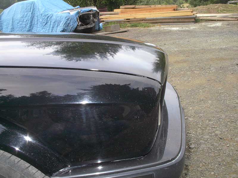

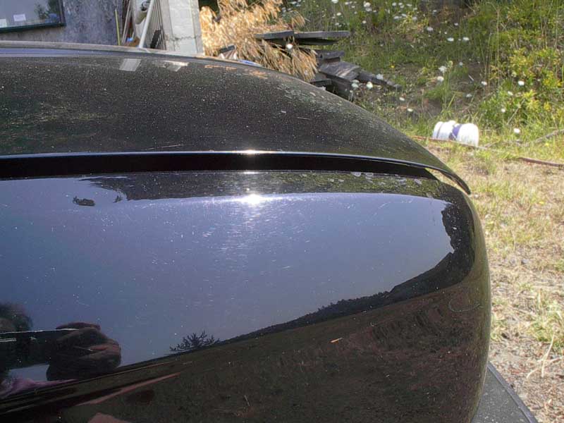

      before and after
      the after pic still looks bad, must be angle of camera it does sit flush in front, bows up a little in the middle then back down in rear
      and it is an aftermarket hood so I think rest of problem is in that. you can see that the hod just would not sit down, using all th instructions in the books and advice at the froums. ws this way when I got it, but was sitting flush on driver side, just way up on pass side, pic makes it look bigger then it was ( and thats a 318 parts car in the back) if you ned parts let me know, Im ight still have it
