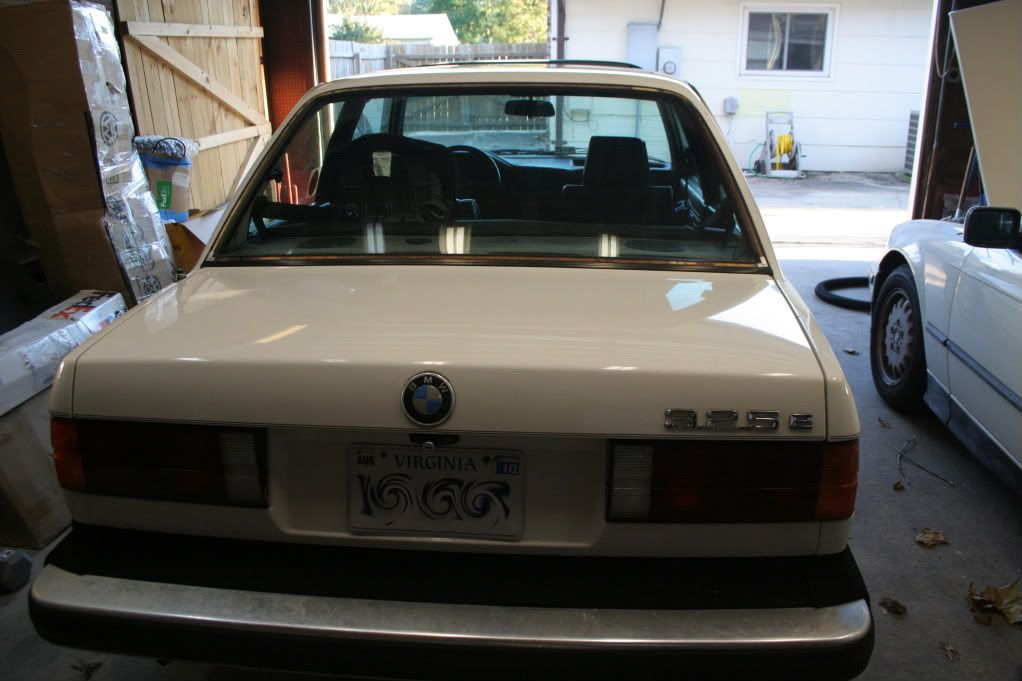

    So heres what I have. Picked up a fairly descent Alpine E30 for $800:
    The paint is in fairly good shape. It is not with out its flaws however. Here are some shots of the rust areas:

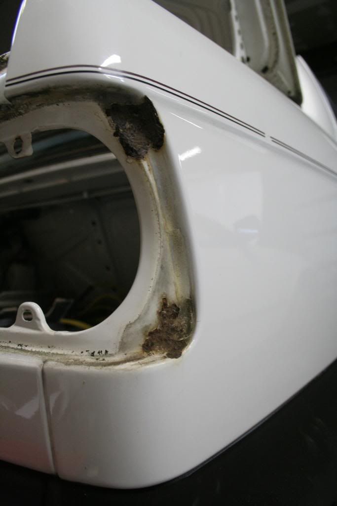

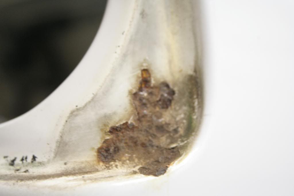

    Passenger Tail light areas:
    Drivers tail light area:
    Trunk seam:
    The battery tray area appears to be solid and no evidence of rust

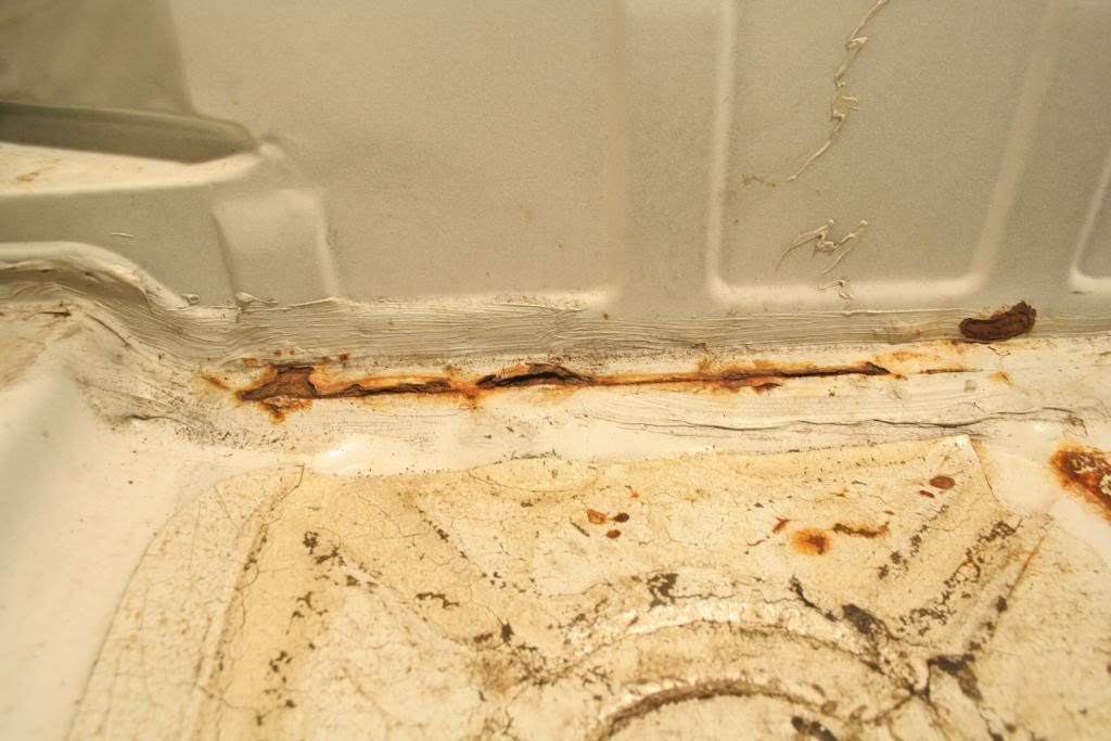

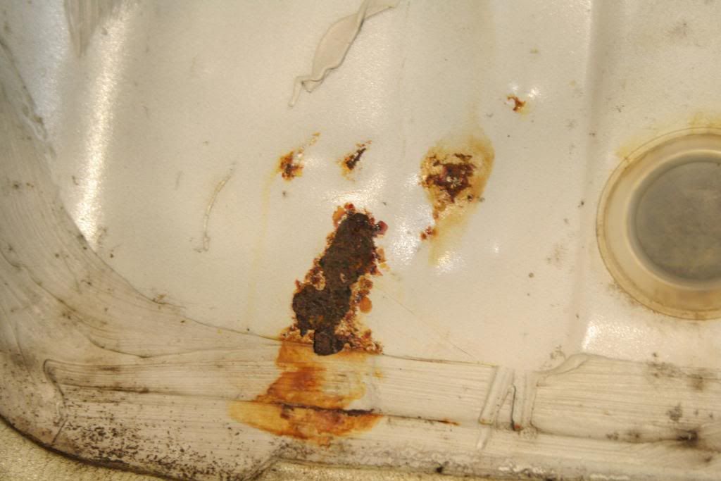

    Other than those exterior areas there appears to be maybe 3 other spots where the paint was chipped and developed rust similar to this:

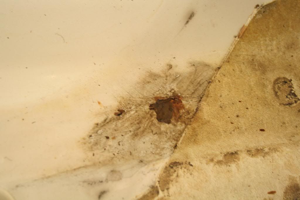

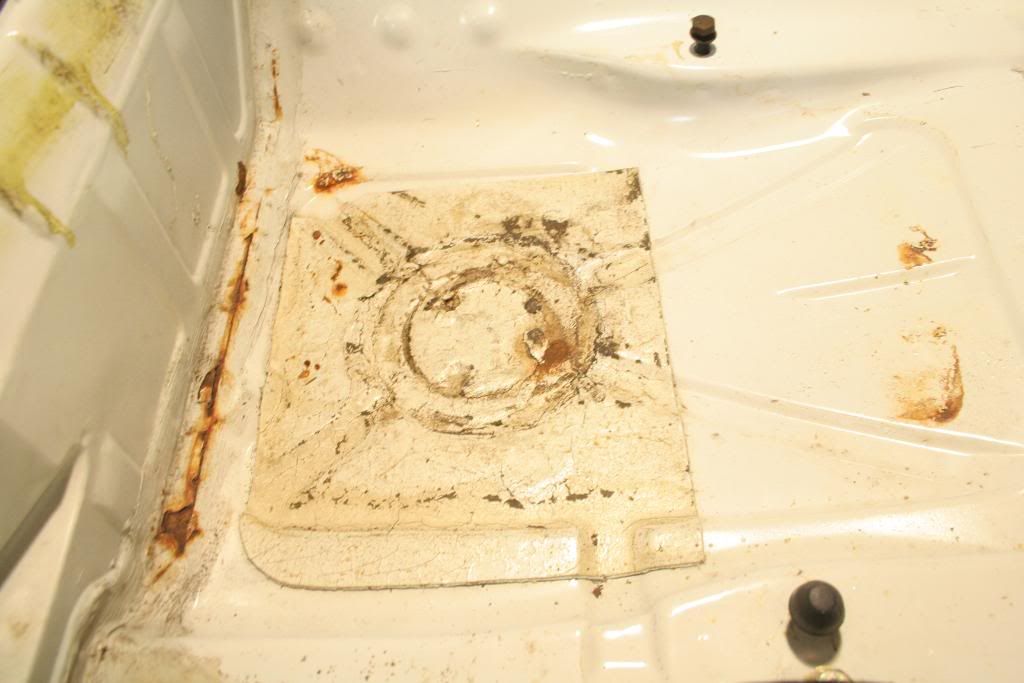

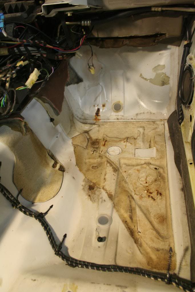

    Next I yanked the carpet:
    Passenger side:
    Passenger rear:

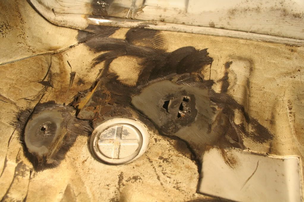

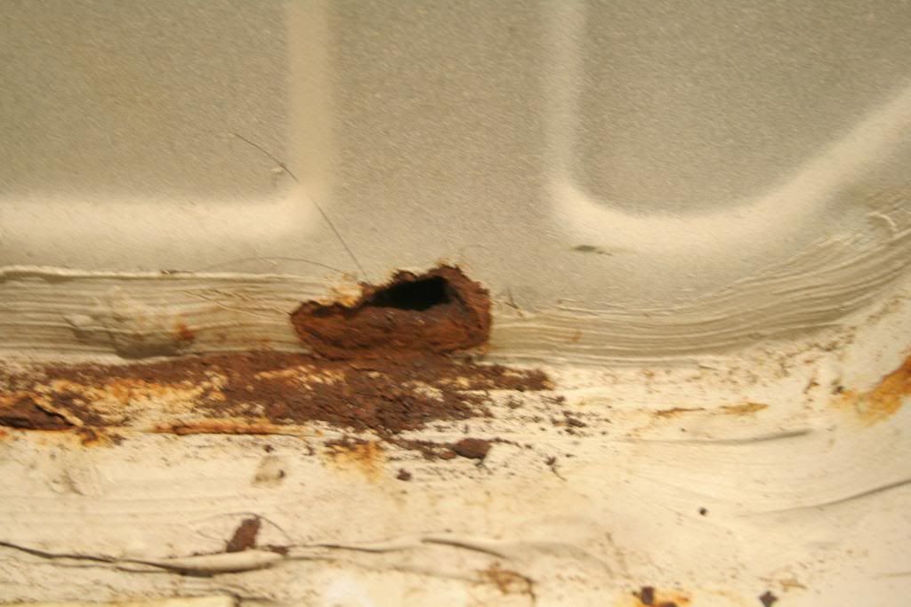

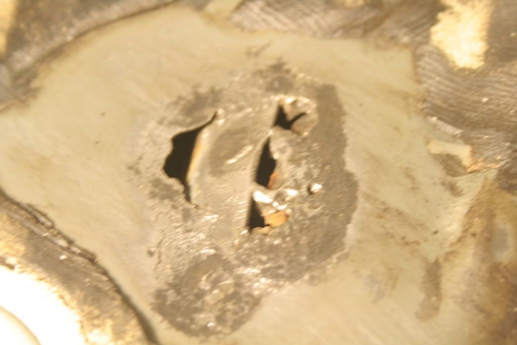

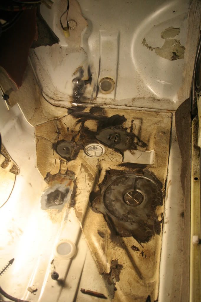

    I was able to poke a hole into some spots in the passenger rear:
    There appears to be no rust in the frame. So I would think I have a good car to start with. Which route would you all go in addressing these rust issues?

    por15 the rust to start so you will have more time. look at your tail light and trunk seals to see where the water is getting in. get under the car and REALLY take a good hard look at everything. poke at the rust areas from the out side and see what happens.

          What areas would you cut and weld? The tail light area looks like it would be tricky?
          Also whats the best way to do the POR 15? Any idea on the color of the stuff from Wurth?
          Additionally, how much paint/material would you remove to assess the degree of rust? Also what would you use? I have a dremel...would this be enough? I am concerned, especially around the tail light area, that I will screw up the paint.

              Clean all areas to see what you have left of good metal. If you have a hole then you will need to cut old metal out until you get to good metal and then weld in a new piece. If it can be cleaned and there is still good metal, no holes, then prep and prime that area.
              Usually we remove at least one inch beyond the rusted area sometimes it ends up larger. The dremel will work or by hand with course sand paper and a wire brush. There is also some acid treatments to clean the metal but I did not use this on my project.

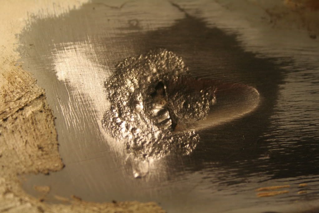

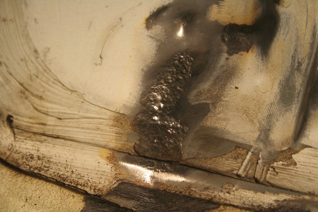

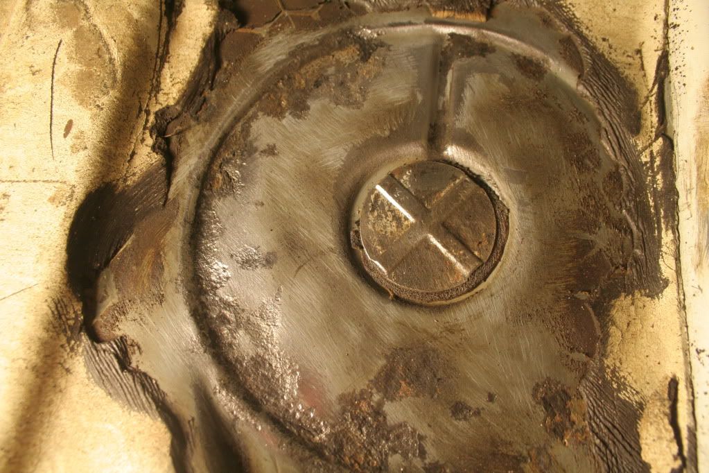

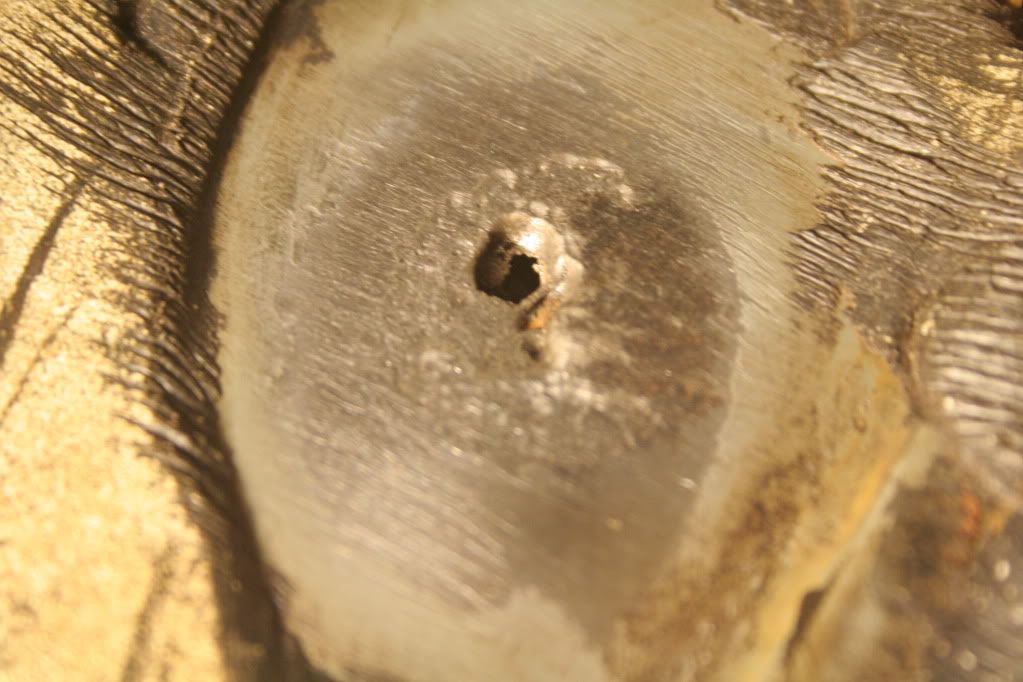

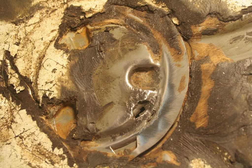

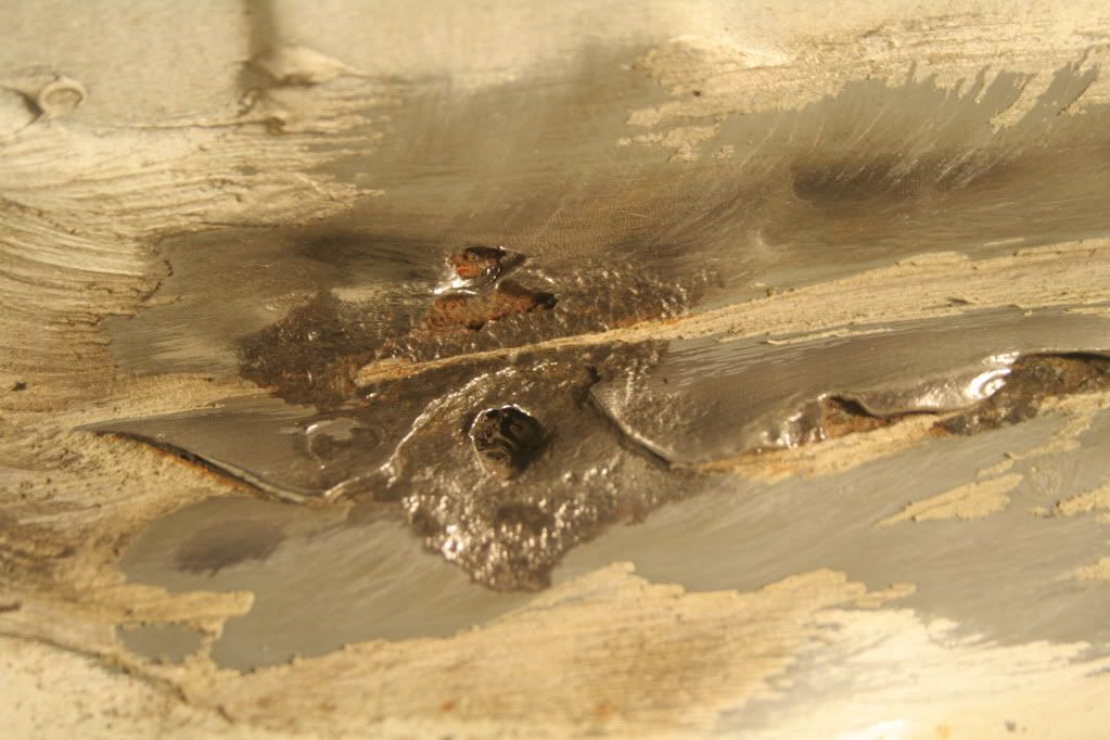

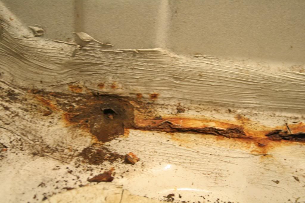

                              Wire brush reveals:
                              Overview of the passenger side that I brushed:
                              Details of the various spots:
                              Rear passenger:
                              Ugh. Cut and weld? Treat it and forget it? It amazing how much rust is really there when you start looking for it.
