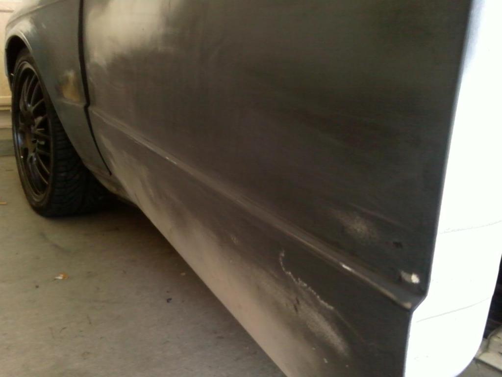

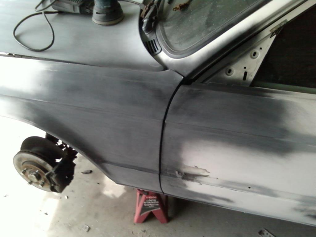

        I am doing this to my car and bought 14' of 2" 20 gauge steel. Here are some pics. I have body filler on the car now but have not taken any pics in the last few days.

                    That looks good!! I am worried if I can get it nice and straight without warping it.
                    Smoothing a whole door pannel could be difficult but you seem to have done a really nice job, I hope it looks this good after paint.... awaiting pics
                    I was thinking about leaving the drop when you get to the lower pannel, but filling in the indentation. Welding in butt plugs for the holes (corrosion/water purposes) then glassing/filler the small indentation, and feathering that in.
                    You would still see the lines or drop from the moulding, but it wouldn't look like moulding used to be there. Seems a bit easier (my skill level) rather then trying to create a completely smooth door.

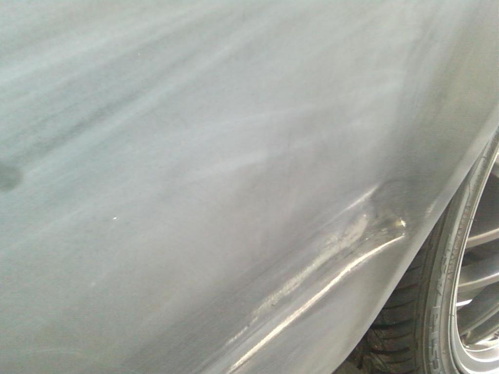

                        i thought about doing it the same way DOLBY is but i think that will somewhat ruin the body lines. i ended up using fiberlass resin and sheet, then boing over that with a long hair bondo-glass. i also made a wood block that mached the body line then just stapled the sandpaper to it so everything would come out even, i wanted it to match the top edge as close as possible and i think its comming out very well.
                        sorry i dont have any pix durng progress, these are after some primer and alittle touch up sanding
