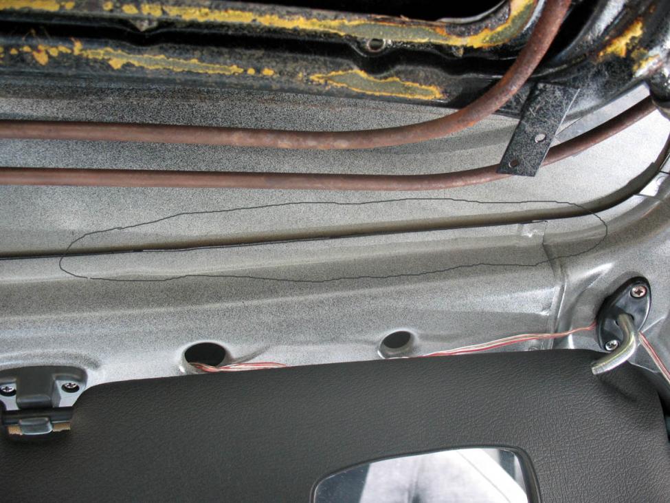

So I yanked the old headliner completely out of the car recently in the effort to make sure that nothing is leaking or rattling before I install a new headliner in it's place.
I've removed the yellow foam that's stuck to the roof thinking I'll be able to buy a new one, well it's NLA so I ended up pulling a clean one today from a parts car.
I've replaced the sunroof seal/gasket with a new one, took the car to a local car wash and of course it's leaking from the rear corners of the sunroof. WTF.
Are these supposed to leak even with new gasket around the sunroof panel or do these need to be aligned perfectly somehow?
Second, I have a passenger side rattle coming from what I can tell a-pillar area but possibly lower, I really though it was the sunroof panel or the hard lines of the manual sunroof mechanism but it's not that. I have no idea what can possibly rattle and sound like metal on metal, but I'll be taking my dash out soon to figure it out.
I can't stand rattles and this one is bugging me.
