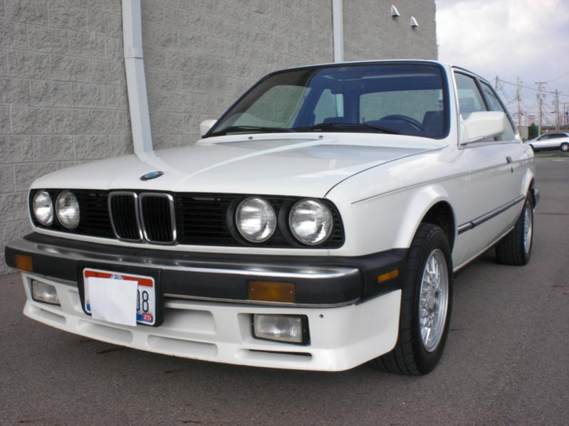

      Looks like this... Hangs kinda low in my opinion

        Thats the stock lip. I'm sure you can sell it, aslong as its in decent shape, cause someone will want it. Then put the money toward a plastic bumper swap from a 89+. The plastic bumper swap is a direct bolt on the front. Just have to cut off the tow hooks and rewire in the pig tails for the turn signals and fogs. But then you have the stock bumper in the back. And changing it is alittle more work.
            That's because it is hanging low. The top of the valence should be flush. Looks like it got snagged and broke/bent some of the hangers it clips to.
            Get it to sit right with some tape on the backside and see if it makes it appear any better.
