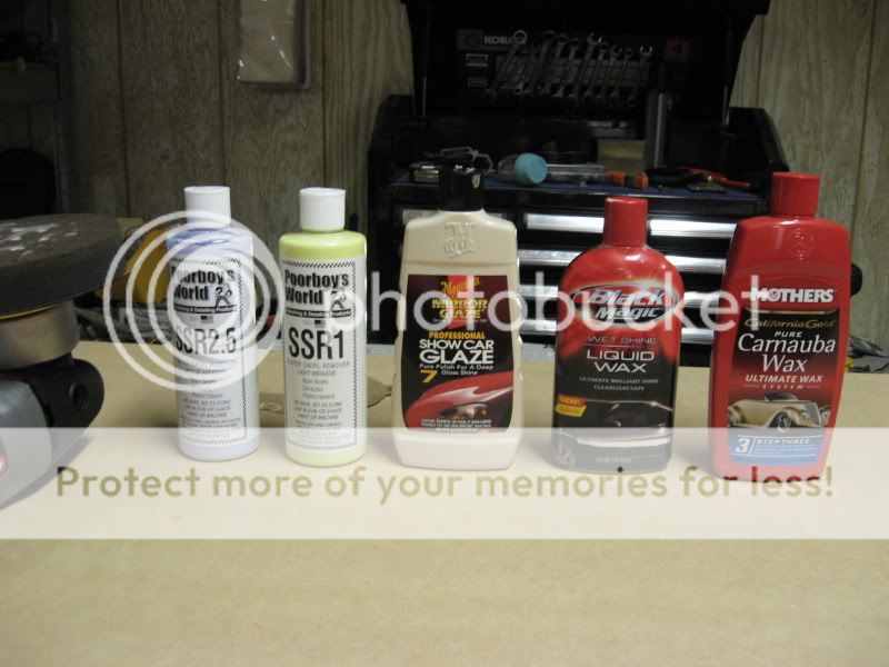

    So I finally broke down and bought $250 worth of detailing equipment and supplies from www.autogeek.net. Highly recommend them btw if you need supplies. Everything from polishers to car covers. Thanks to adept for his detailing walkthrough as it helped greatly.
    Bought:
    - 7424 Porter Cable DA
    - Poor Boys SSR 2.5
    - Poor Boys SSR 1
    - Various microfiber towels (mequiars)
    - Various polishing, buffing, waxing pads (8 total)
    - Diapers

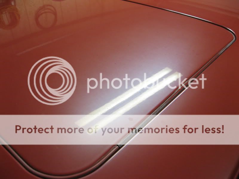

    Now, I have pretty bad paint on my car so I was pretty excited to see exactly what this stuff could do. I was pretty impressed with the products and less impressed with my paint than I was before. LOL I knew it was a crappy job, but this confirmed it. Looks good now though at least. The process removed 100% of my swirl marks (seriously) and tons of actual scratches and blemishes.
    Process:
    - Tape trim off with painters tape
    - Clay car with any brand clay kit
    - Poor Boys SSR2.5 w/ Orange cutting pad @ speed 6
    - Poor Boys SSR1 w/ Orange cutting pad @ speed 6
    - Meguiars Mirror Glaze polish w/ White polishing pad @ speed 4
    - Black Magic liquid wax w/ Black finishing pad @ speed 2.5
    - Mothers Pure Carnauba wax w/ Red finishing pad @ speed 2.5
    This whole process took FOREVER. I would guess I have 12 hours into it so far and I still have to hand do the bumpers and other machine inaccessible areas. But it made quite the difference to even my sh*tty paint.

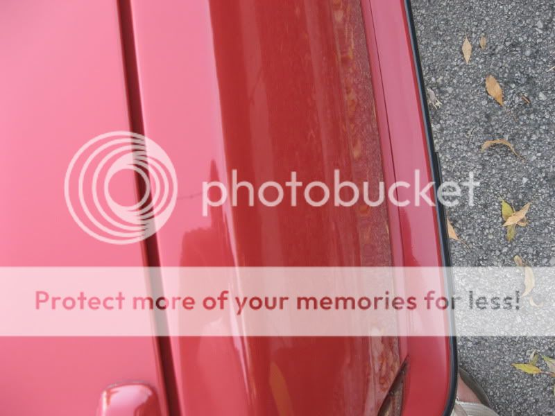

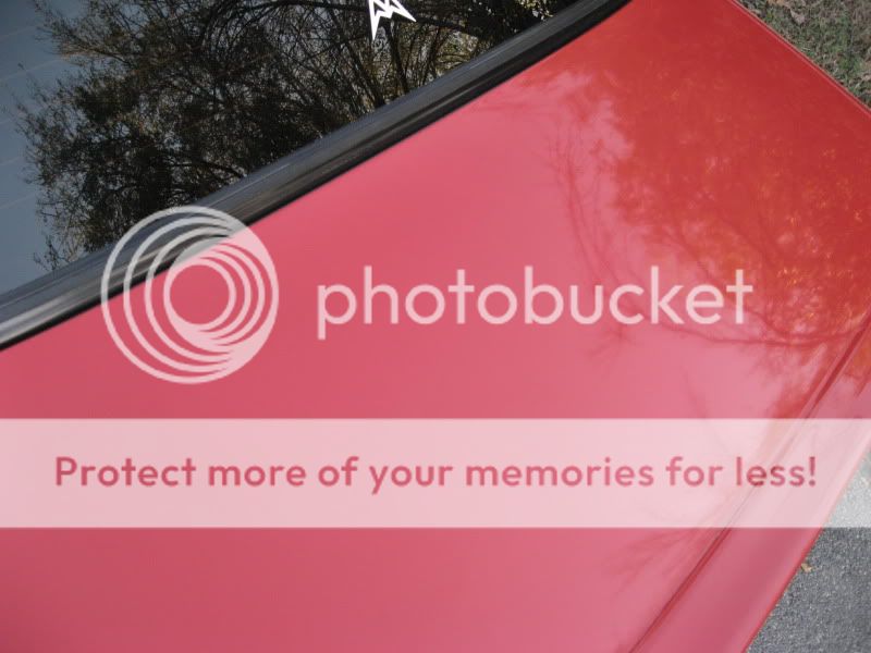

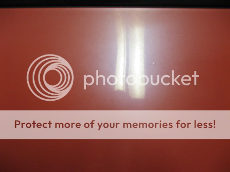

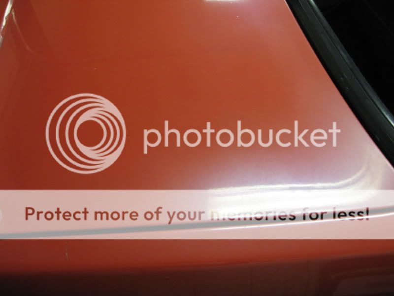

    Before:
    Trunk
    Trunk
    Sunroof
    Roof

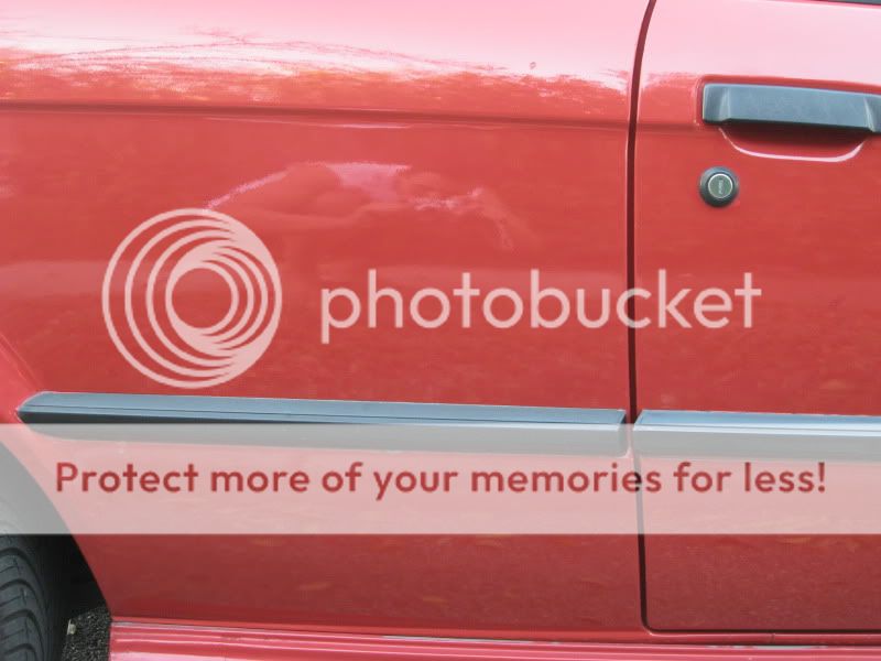

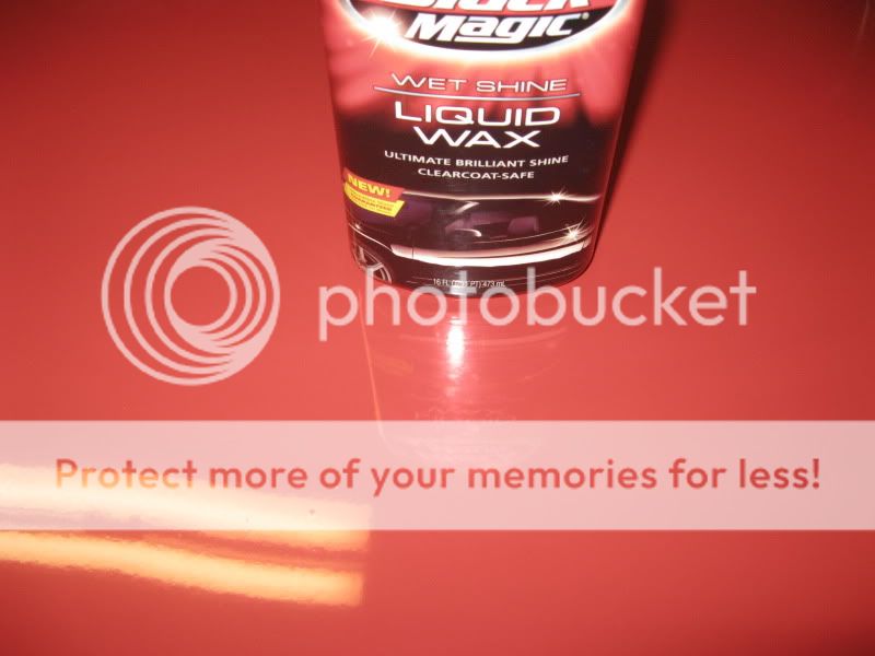

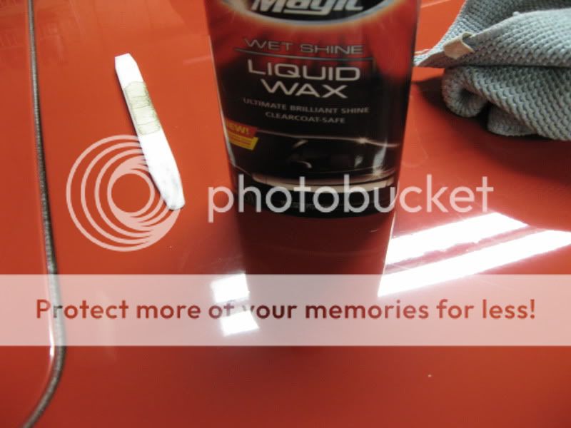

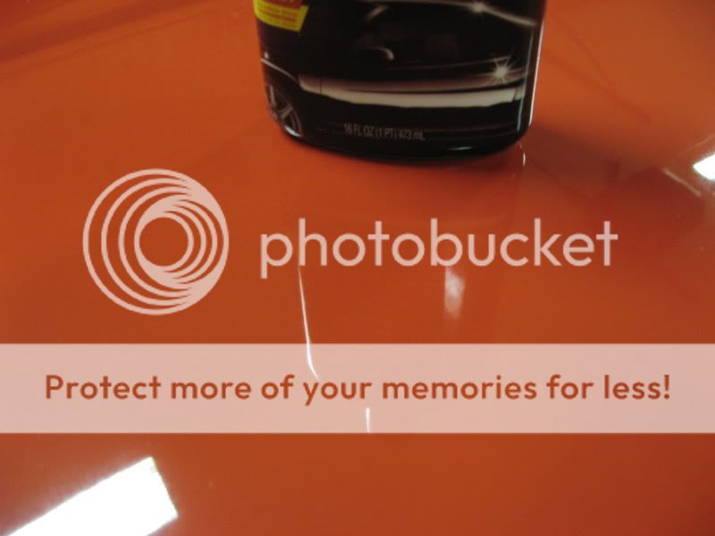

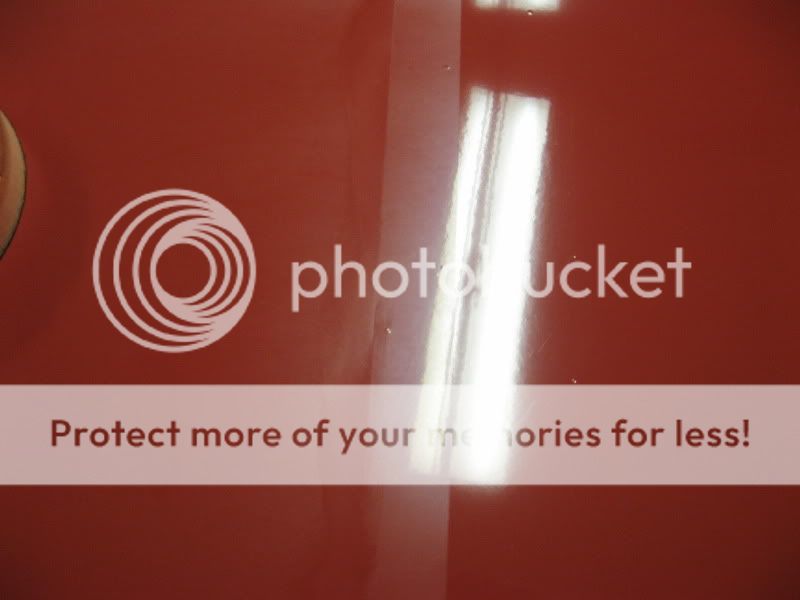

    Trunk half done with all steps but carnauba. This made me smile, and then frown after I realized how long it was going to take to do the whole car.
    Comparison 2

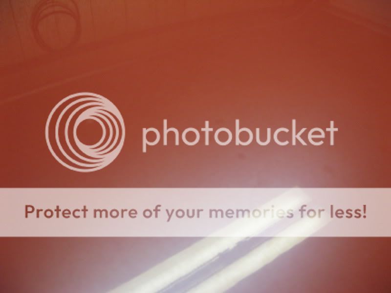

    During: All steps done but carnauba wax on these shots.
    Trunk
    Trunk

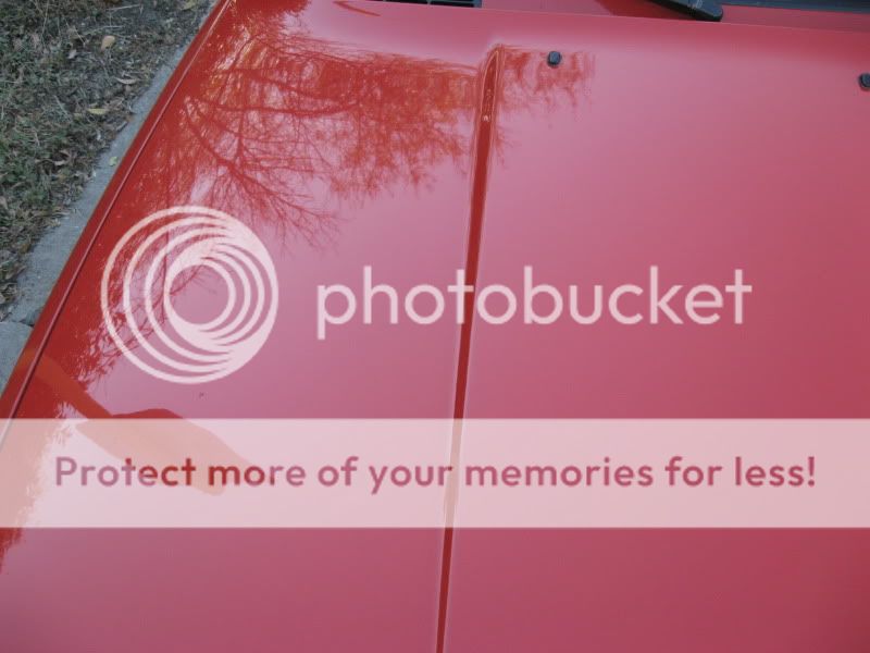

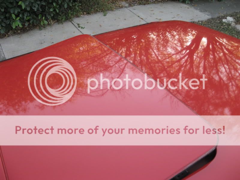

    Sunroof
    Roof
    Roof w/ flash

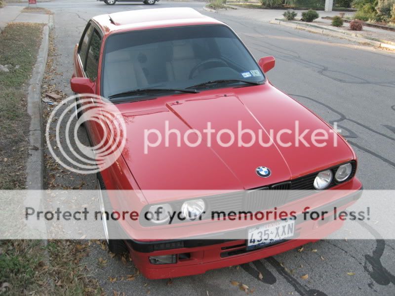

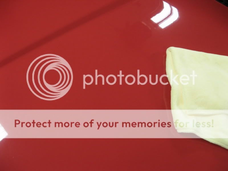

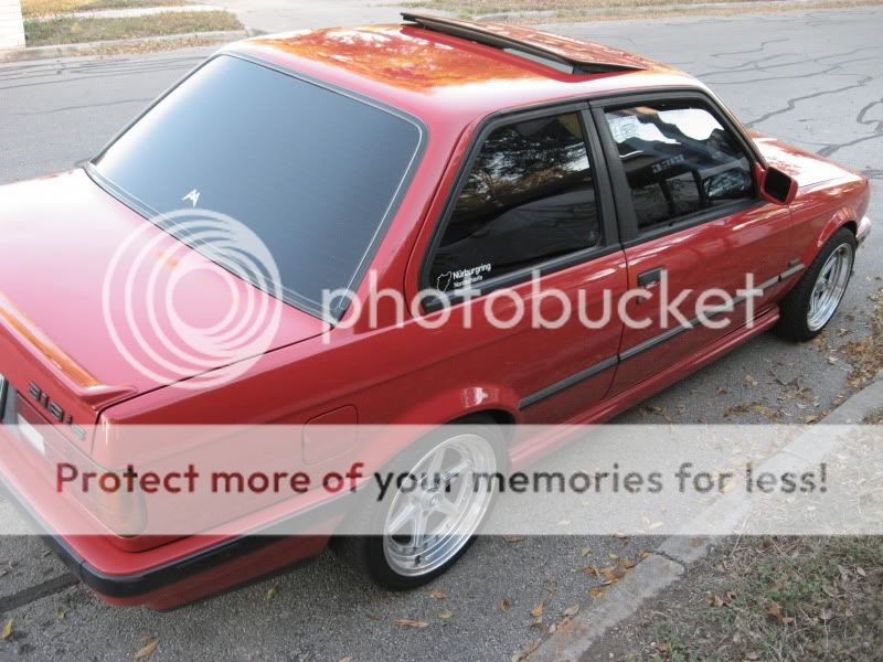

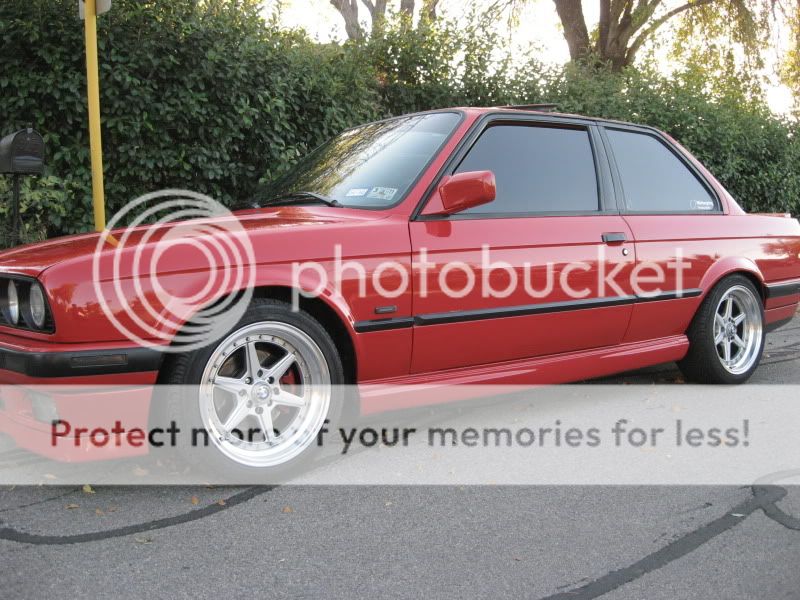

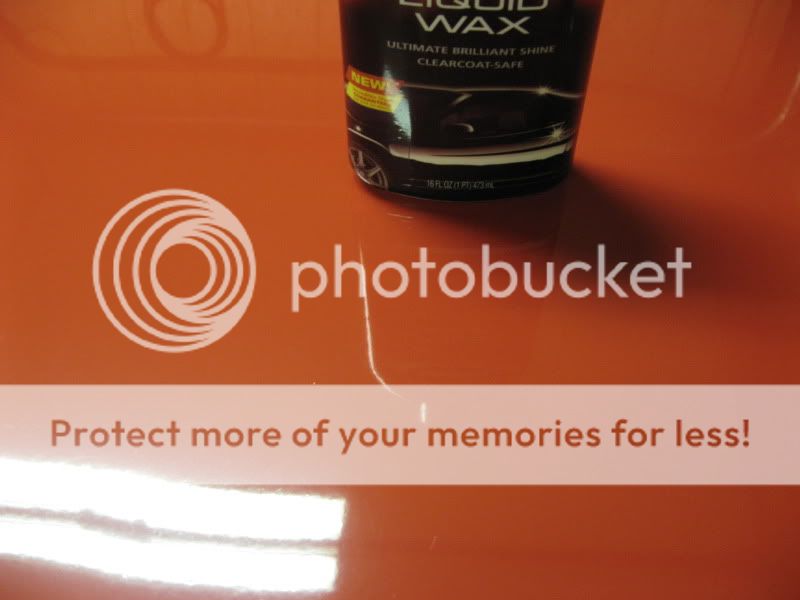

    After: time for the money shots. These are completely unedited with just a point and shoot camera.
    Hard to see, but I haven't done the bumper and I was trying to get a comparison shot between the finished car and the untouched bumper. VERY obvious in person.
    Well, tell me what you think. Waste of time, or man that looks much better?
