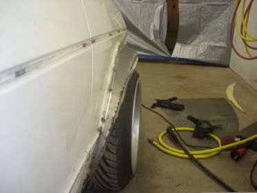

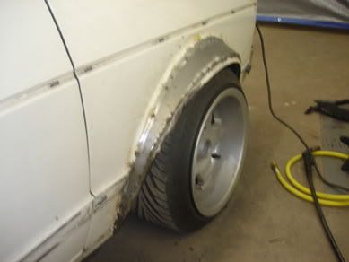

            I folded the entire seem out, including the pinch welds. Its atleast an inch wider.

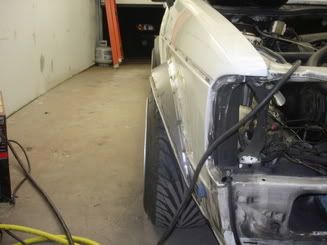

              On a golf project a few years back we cut the metal in between the flare and the body until there was just a little metal on each end. We then pulled the flare out, cut sheet metal to fit in the gap and welded it. Looked really great when the body work was done. I might have some pictures on my home computer. I'll check after work if you are interested.

                  Ill take a couple pics of it finished. I redid this side a little bit more.

                        I did some searching since we couldn't find our progress pictures.
                        You can see in the pictures that the original fender lip was cut off and a new piece of sheet metal was welded in between the quarter panel and the old factory flare...

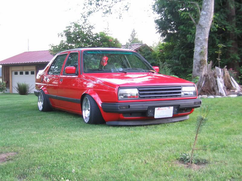

                        Another method although I wouldn't suggest it as it won't look nearly as clean or stock : http://forums.vwvortex.com/showthrea...idened+fenders
                        The VW community has been doing this for years and if you search on VWVortex, you'll probably find more info on how they did it. We had about 100 hours in when ours was finished up, but we even rolled the outer edge in so it would look stock and still have some strength. PM me if there is anything I can do to help out.
