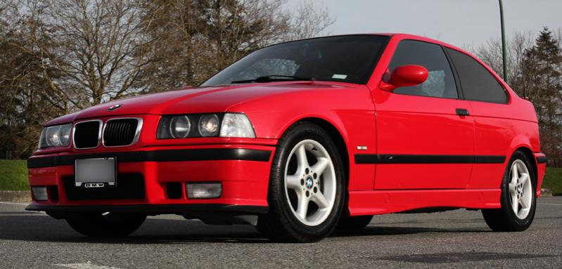

                so i just found a thread from e30tech about this. the 318ti clubsport has an m sport package with identical moldings to the e36 but a little smaller. it looks like it fits the e30 almost perfectly and modification should be very minimal. i think im gonna order it from turner and give it a shot.:pimp:

                  From what I remember from back in the day when the av3 kit was the new hotness you had to use 2 kits from an m3 because the front fender piece was too short. You needed 2 rear pieces and a door piece for one side.
                    A member over on a 318ti forum was kind enough to measure the lengths of each molding piece.
                    318ti:
                    Front fender : 8.75"
                    Door: 48.25"
                    Rear Fender: 21.5"
                    Total Run: 78 15/16"
                    My E30:
                    Front Fender: 9 11/16"
                    Door: 47 1/8"
                    Rear Fender: 19 11/16"
                    Total Run: 76 11/16"
                    It's soo damn close. The door is the only piece that really concerns me. These moldings also bevel at a different angle, so they just may fit.
                      I had them on my 2nd car, Big painn to get the standard e36 ones to fit. The door molding had to be shortened about 1.5". The front fender was easy, but I could never get the rear to fit flush. It wasn't too noticeable but it DOES work.
