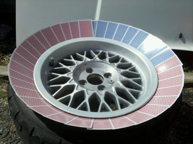

    I may not be the first to do this but I have never seen it done before so I thought I would share. I had perfect results , was even able to get paint into the bead. Used 3 decks with about 15/20 cards left so 3 decks should work up to 17" rim. Bought the cards at the dollar store, was cheaper than a roll of blue masking tape, and took less than 5 minutes to set up.

    nice! thanks for the tip. i will use this the next time i paint my wheels

      Ive used index cards before too.
        Did that once to repaint some old winter wheels. Works like a charm!

          I used some poster paper and cut it up into rectangles

                +1 on the index cards as well. Worked great for a quick repaint on my stock weaves.

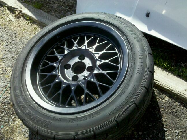

                  Nice tip. Pics of Ronals on the car?

                      Thanks guys, ill post some pics on the car soon, kinda slacked on the center caps, just started prepping them this weekend. And yes the are Ronal ls.
