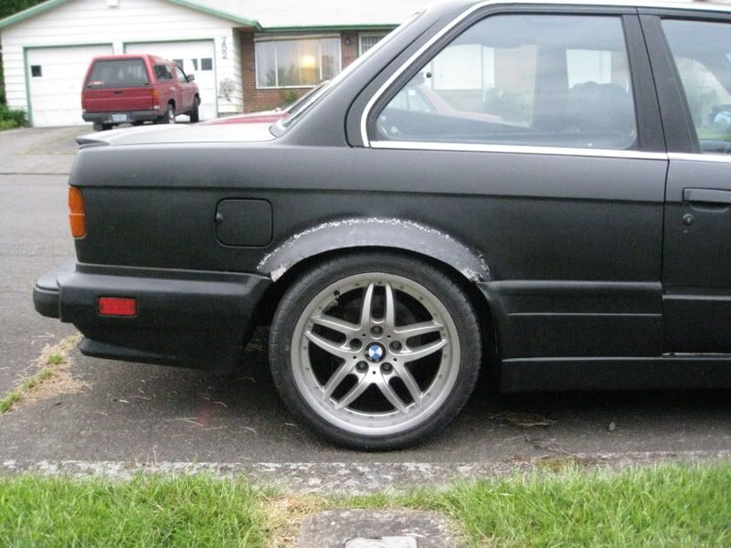

          I did this to my 87is. I started with the front like you with hammer and dolly and when I got to the rear I found a nasty surprise. The seams were spot welded and seam sealed. I spent a lot of time with a grinder cutting out the spot welds to separate the panels. The seam sealer makes a very nasty smell when it gets hot… do yourself a favor and stay away from the black smoke. Because of all the under body coting and seam sealer I opted not to re-weld to avoid inhaling any more carcinogens and filed the gap with fiberglass filler. I still have alot of work left to do...

              @lovnbmws, what are your rear wheel/tire specs?
              • Vivek
                attention whore/retard/bitch
                • Oct 2011
                • 6167
                I think they're like style 71's, ummm 17x7(.5?). Looks like he's missing a lug bolt...
