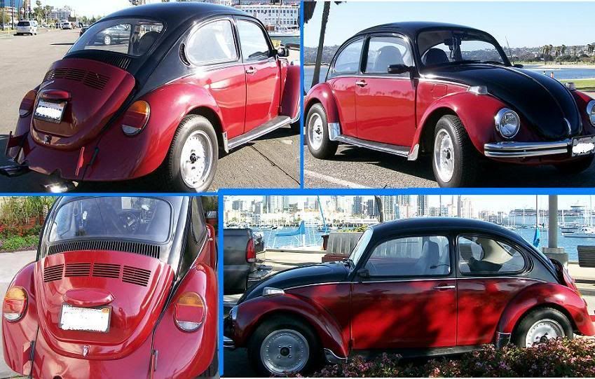

    Here's a guy who painted his car with Brightside black and showed his progress along the way: LINK
    A few of his pictures:

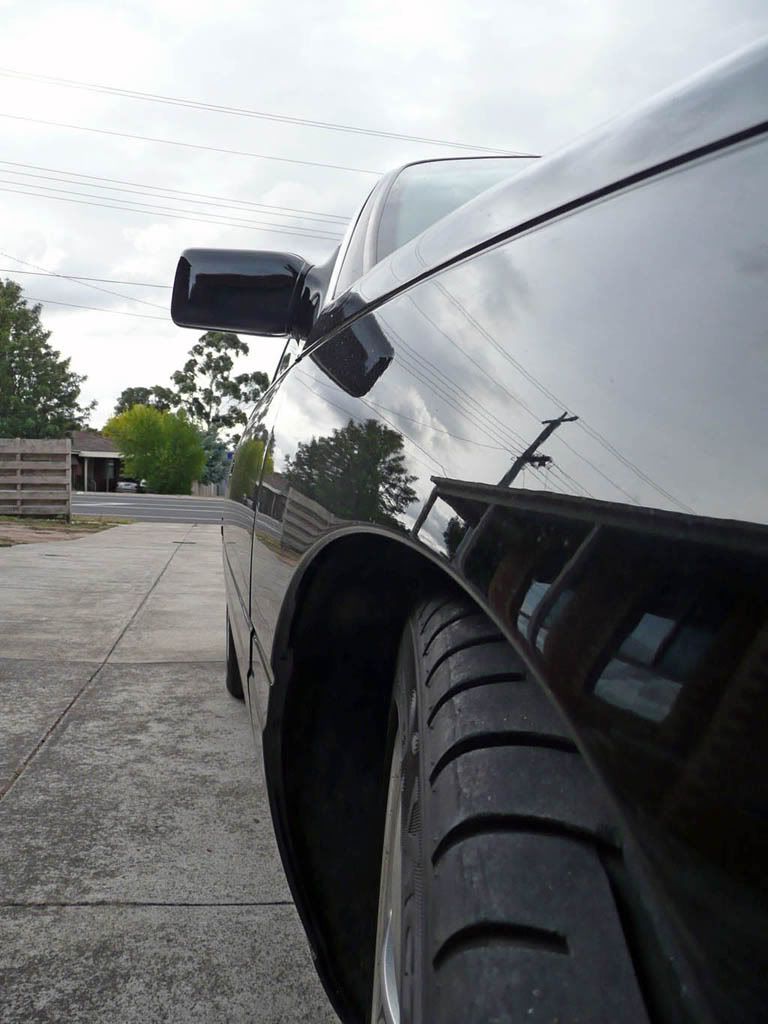

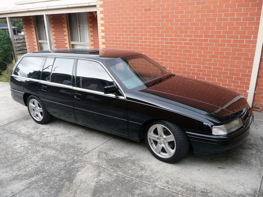

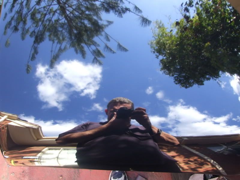

          Here's some more pics from the moparts forum:

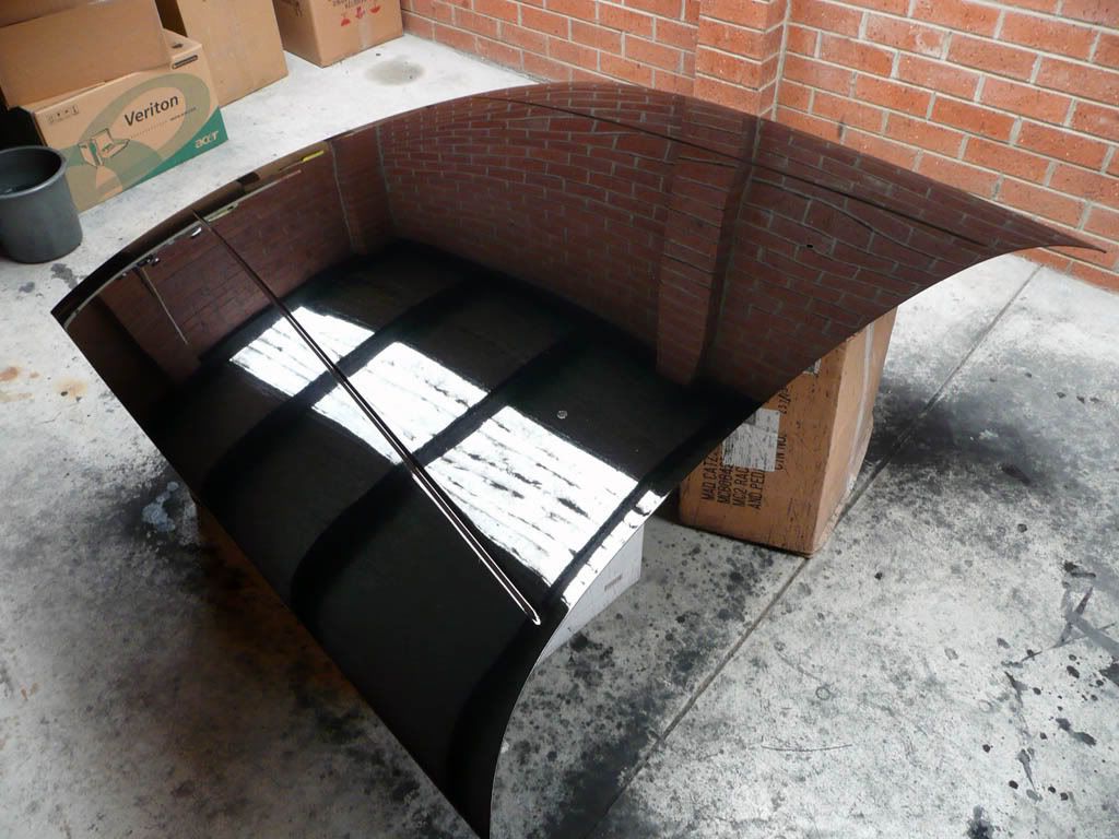

          Check out the posts by "Aussie Driver", he was one of the first to paint his miata with Brightside black thinned with Penetrol. Below is a pic of his hood after he wetsanded out the dust nibs and polished it.
          On the test panel I did with brightside black I got really nice crisp reflection like the photo above and I just slapped the paint on with a foam brush. So far the paint seems surprisingly durable for a one part paint with no hardener. Best part about the paint is it will be very easy to maintain and touch up if need be, so it should work perfectly for my beater work truck. I may even paint my car with it too depending on how my truck comes out.

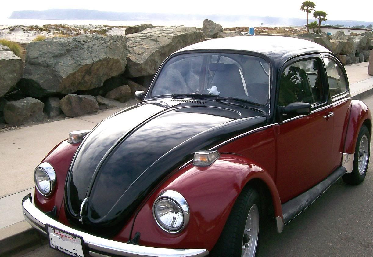

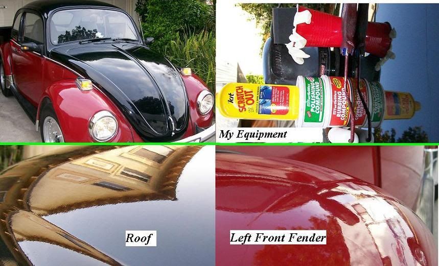

          Anyway, here's a few other pics to motivate you. This guy used brightside black and Pettit's Easypoxy Burgundy. I don't believe he did any wetsanding or polishing on the final coat since he didn't mind the orange peel.
