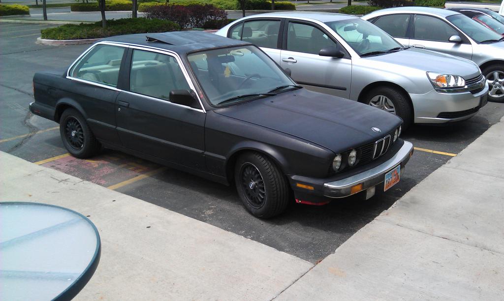

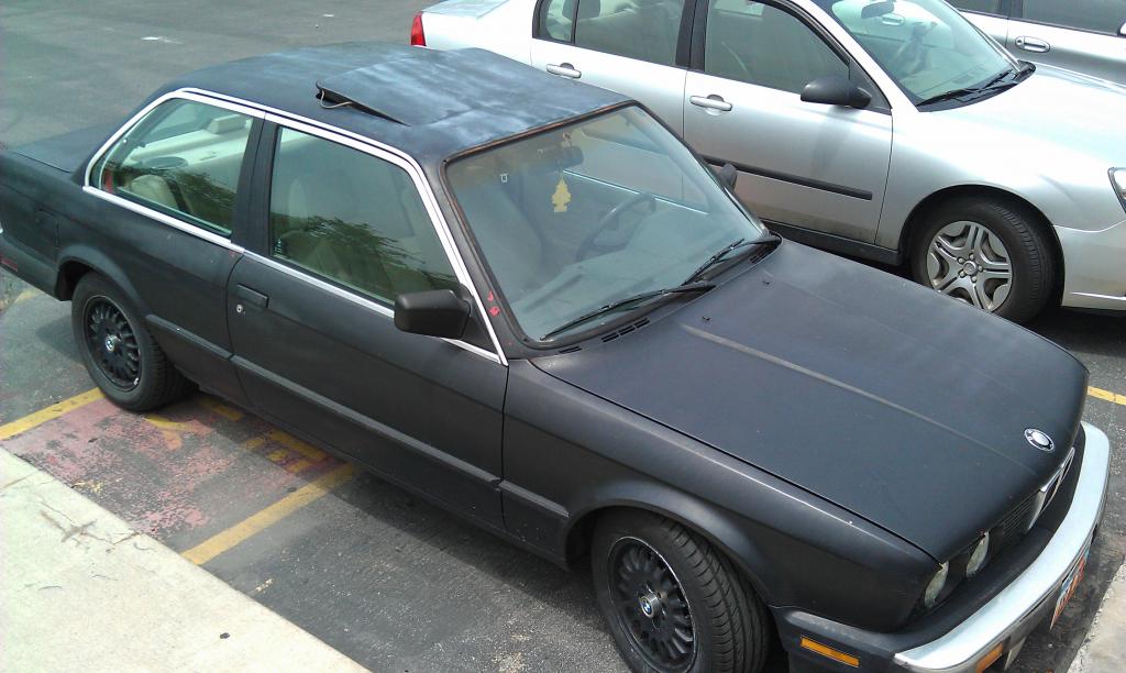

    one of my car's POs did a pretty bad rattle can job. I wet sanded a spot on the hood that looked like someone tried to wax it, and it looks okay... Or at least better than the rest of the car.
    There's no way I'm going to blow $1000+ on a paint job for a car worth about that much if I'm lucky.
    So my plan this weekend, is to get a can of flat black (to fill in chips and such), some fine sandpaper and a bucket of water and have at it. is there anything I'm missing? or a link to a good resource for proper wet sanding technique?
