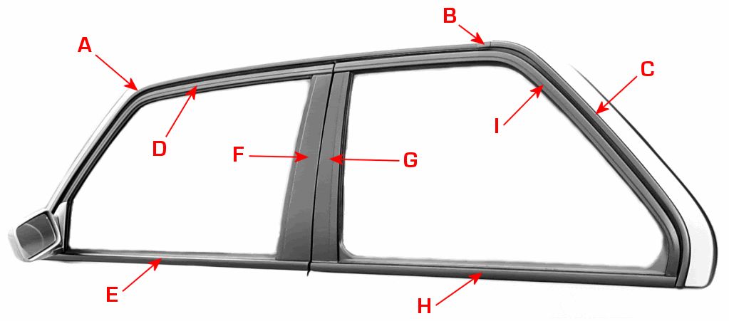

Hello all-I need some help with removal of the trim piece labeled 'H' in the diagram (2-door fixed rear window 318is). Can anyone offer any guidance? Any thoughts are greatly appreciated.
Need help with exterior trim removal

It can be done but it's very difficult, you'll have to remove the fixed window and drill out the rivets that hold that trim. Not worth the risk of damaging it, go find some clean ones or polish the existing ones.They call me the frog

I just did it for my pop out windows. It isn't easy but I did it. Getting them back together properly is really the hard part but do able.
Drill out the rivets and use heat gun to make the adhesive plyable. It is still hard to get off but that softened it up enough to pull the parts of with damaging them. I am talking getting hot to the point where it was smoking. Used leather gloves and pull haha. Use your better judgement when doing this is my best advice.Comment

H, G and I are all riveted together. It is easy to remove the assembly from the window, but the window has to be out.I don't always wreck cars, but when I do I wreck them into trees.
