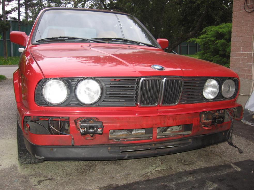

    Going to be mounting an mtech 1 in its place and just from eyeballing it, it looks as though the mtech fogs will hit.
    How does the front metal valence on an early car (vert) come off? Diagrams or pics would be very helpful!

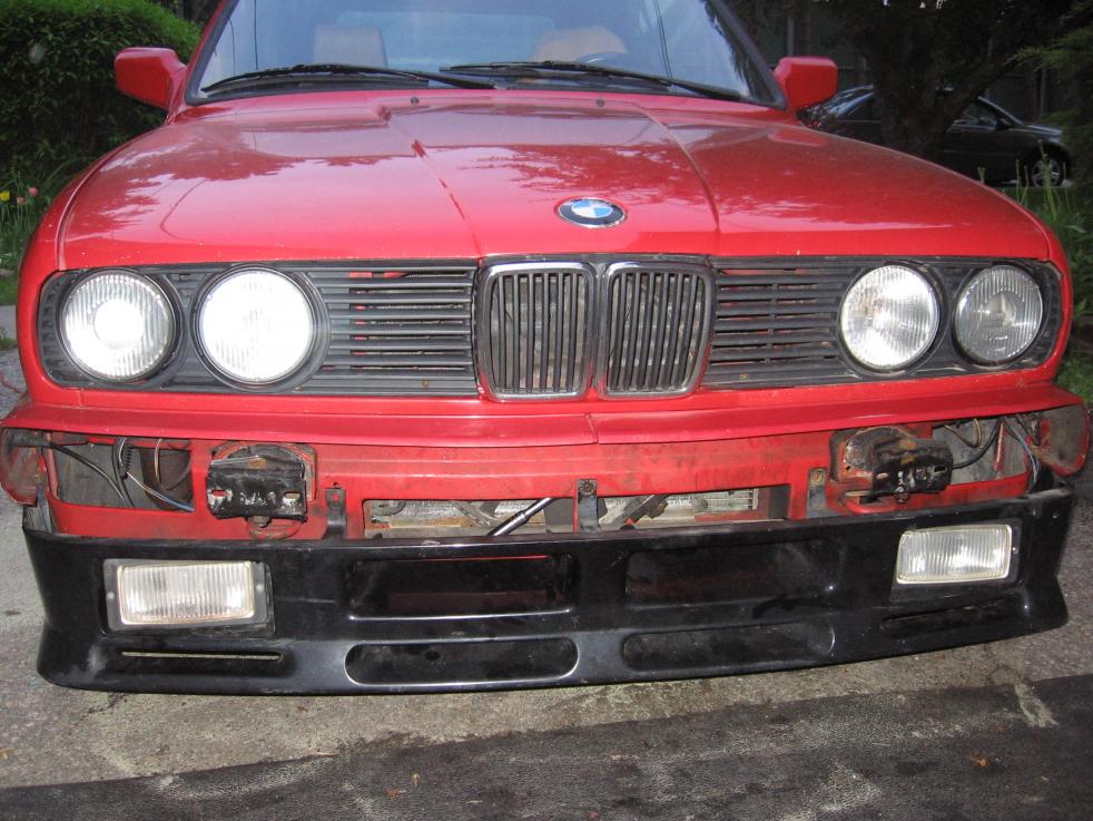

        you don't need to remove the valance to install the m-tech 1 (early m-tech that is) I have one on my 87-vert as pictured.
        You will need to remove the bumper. either the bumper shock from the frame 4 bolts or the bumper shock from the bumper. you can see in the first pic this has been done.
        I lined up the spoiler to show the existing holes in the valance line up to the brackets that are on the spoiler. You need these brackets to afix it to the valance. the valance is pre-drilled from factory to mount the spoiler.
        the last pic shows you the finished product.
        note: it will be tricky to get the upper nuts tightened so be patient.
        GL

          • M-technik-3
            • 18946
            you need a non North America valance other wise as you noted the fogs will hit the valance. Iassume your Tech I is cut out already and has fogs?

              My car has front and rear euro bumpers. I read in another thread that I do not need to run any valences underneath as it did not matter since the mtech 1 mounts over top of it.
              The Mtech 1 bolts up to the front euro bumper and I already took care of mounting my euro bumper to the car. Eyeballing the existing US spec valence and the mtech 1 - the fogs sit up higher and that was my concern if the fogs would hit the US valence.

              • M-technik-3
                • 18946
                Early valance US for oem NA fogs
                Tech I minus the fogs mounted with same NA valance fits fine but with fogs does not.

                  • M-technik-3
                    • 18946
                    Yes and no, if you do so your fenders flap in the breeze. If you have fogs, mock the valance and just trim out the offending area..
                    M tech I fogs are E30 M3/ E28 fogs if yours are pitted.

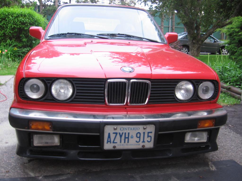

                      • fporro
                        • 1860
                        theres's also a gap on corner where fender meets bumper, that will be noticible if a US (early) or no valance is used.
                        get a euro unit with slot for oil cooler !
                        mt1 fronts come for Automatics with no oil cooler slot and manual with single or dual slots ;)
                        fogs mount to mt1 not valance and MB fog lights can be used a frenchie low/hi beams
                        here's my us 87 325ic, from db's to mt1 with euro valance from manual transmition car.,
                        notice that mt1 fog mount points clear through the valence opening
                        single slot :(
                        my Dual slot :)

                              Thanks guys. Did quite a bit of cutting tonight just to discover I will have to cut
                              my driver side tow hook and it should fit like a glove by tomorrow!!
                              I am single slot right now by the way and considering going dual slot.
                              I guess down the road if a euro valence becomes available I will grab it.
