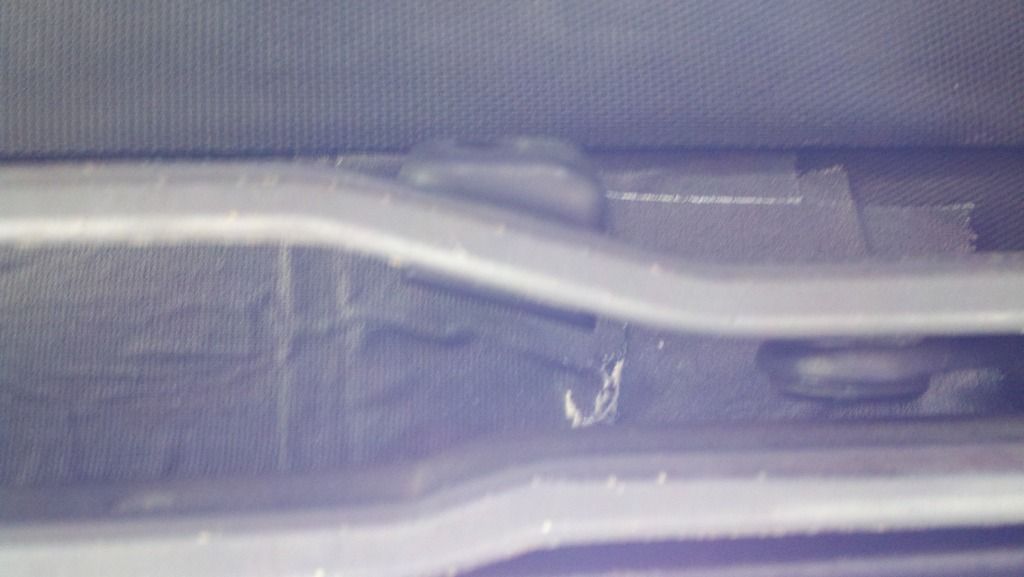

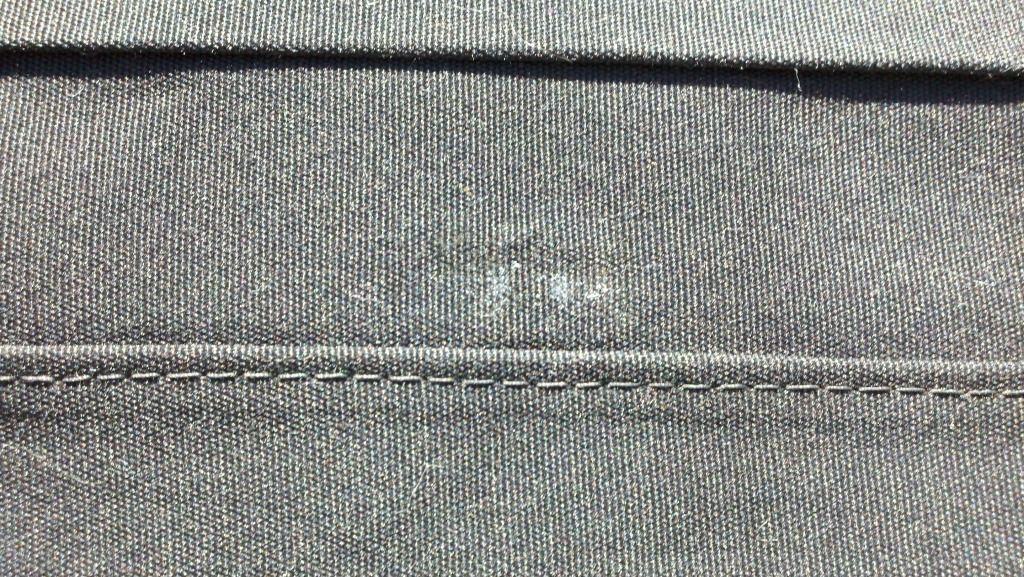

                Here's what that wear spot looks like on mine, with gaffer tape applied to the inside. The white is the adhesive on the tape, which bled through the fabric a bit:
                I tried a picture of the inside with the top closed. I kept getting a lot of glare, but here it is anyway:
                It looks to me like it is the exact same spot as yours, judging by the somewhat oval shaped plastic piece.
                I used three layers of gaffer tape. Can't remember the exact size, but big enough pieces to cover the hole with plenty to grab onto the surrounding fabric.
                Hope this helps!
