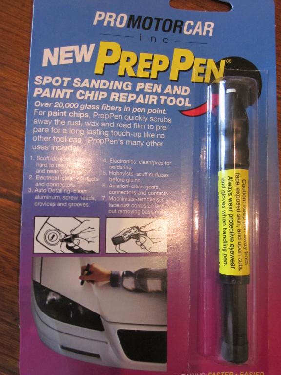

                      Prep pen and Dr. Colorchip ftw
