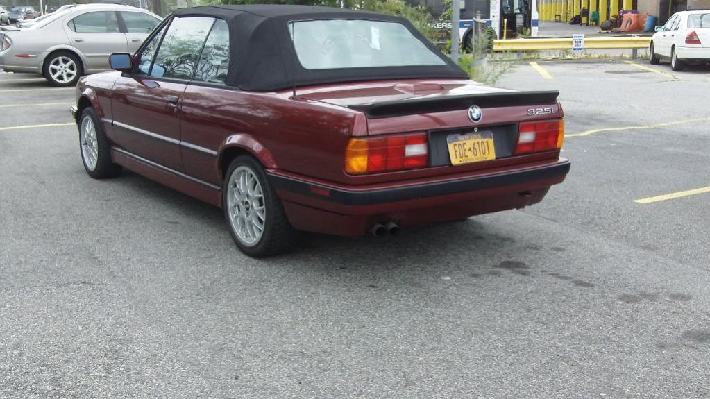

          Hopefully boomer doesn't mind me using his pic, here's a pic of coupe m-tech II skirts on a vert with the stock rocker panel molding above it. I think a modified e34 m-tech skirt would look very similar.
              [ATTACH]61099[/ATTACH]
              I actually bought some MT2 skirts and test fitted them. I just couldnt get over the lip that would remain since I wont have the pods. Since I have a lighter colored car, the lines will show more than a darker colored car. I have referenced that pic several times, and something just doesnt work for me...may it just needs to be lowered.
