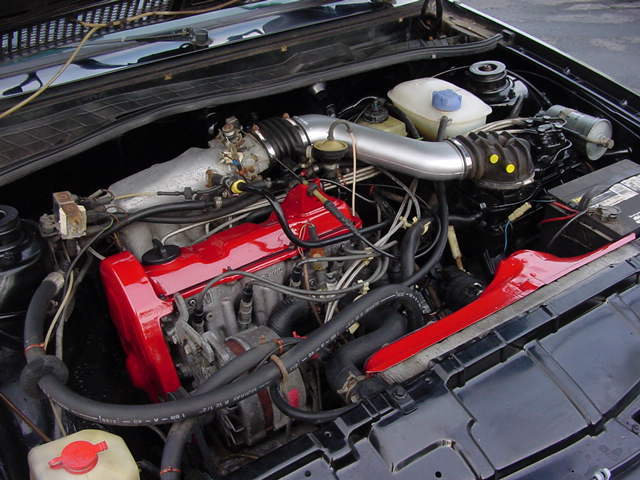

          ive used rustoleum before with very good results on my engine parts. never had any wrinkle after clearing it.
          just wondering about this product because ive tried sem and dupli with promoter and they still chip after awhile
            Did you wet-sand and layer the rustoleum? How many times?
            I was shooting for an actual professional-looking glaze on my motorcycle project, and after 3-4 coats it developed some nasty wrinkling no matter what I did. I wish I had some pictures of it... After calling a local store that stocks specialty aerosol paints, the guy guessed exactly what paint I was using based on my description of symptoms.
            • grays
              • 1343
              nope just sand/prime/paint/clear about 20mins or so
                    Ah, that's probably why it worked. I was trying to sand out the orange-peel that spray cans inevitably provide, which meant I ended up putting on more paint than you probably did. If Rustoleum gets thick at all, you end up with issues.
