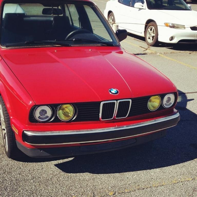

                  Yo
                  Water tight with pressed DB

                    Looks awesome. Did you use the clips from the rear or bolts with washers and nuts?

                      The clips that usually snap in with the rear bumper, they are a bit wider than the holes in the bumper...there's also a clip that hangs off the front bumper itself. First you need to take a pair of pliers and snap them off because they will push the rubber out and prevent a flush fit. Just wriggle them until they snap. Slide the snap pins into the groove the rubber has. Carefully and I mean carefully line up the bumper and rubber pieces, line up the snap pins, put a rag or some cloth on the rubber. grab hammer and smash them in. Once all snap pins have been hammered in take some adhesive silicon and line it at the top portion of the rubber where it meets the bumper (make sure it's black in color for obvious reasons.). Apply some weights and let it sit overnight. In the morning take a razor blade and cut off the remaining adhesive. It takes a little thought and ingenuity to get it to sit flush but you can get it to work with some patience and elbow grease.

                        Thanks a lot for the help. Going to do this. I think it looks great and will do until I can get my hands on some euros.

                            So I finally got around to doing this. What have you guys done about the blinkers.

                              Looks good
