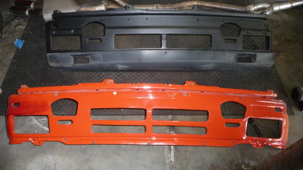

        I thought there were two euro valance types. The early euro valance that had a lot of slope to it and used the fog lights that mounted to a stamped metal bracket. The late euro valance that was flatter across the face and used the fog lights with a plastic frame that mounted directly to the valance and then the facelift valance that was the same as the US version model. In the photo below, the black one is what I call the late model euro valance and the other is the early type. The chin attached to the black valance should be on the bottom one.

          You're right there are two types but they are both intended for early models.
          Bottom line is it will look very odd with a diving board bumper.
