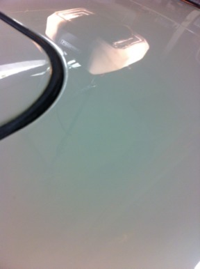

    This has probably been said before but wetsand.
    I've does the clay and polish but NEVER has it made my car so shiny.
    Get a 2000 sponge from pepboys and start sanding.
    Polished by hand, then waxed. It's silky smooth and definally breathed some new
    life into the paint.
    I was so impressed I took pic. :)
    The color is grey btw.
