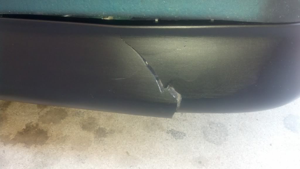

    Picked up a cracked lip from an 88' vert in the junkyard for $10. Saw the early lip on ak-'s car (Abbi) and figured I'd give it a go.
    Test fit #1.
    It has a face.
    Bad crack.

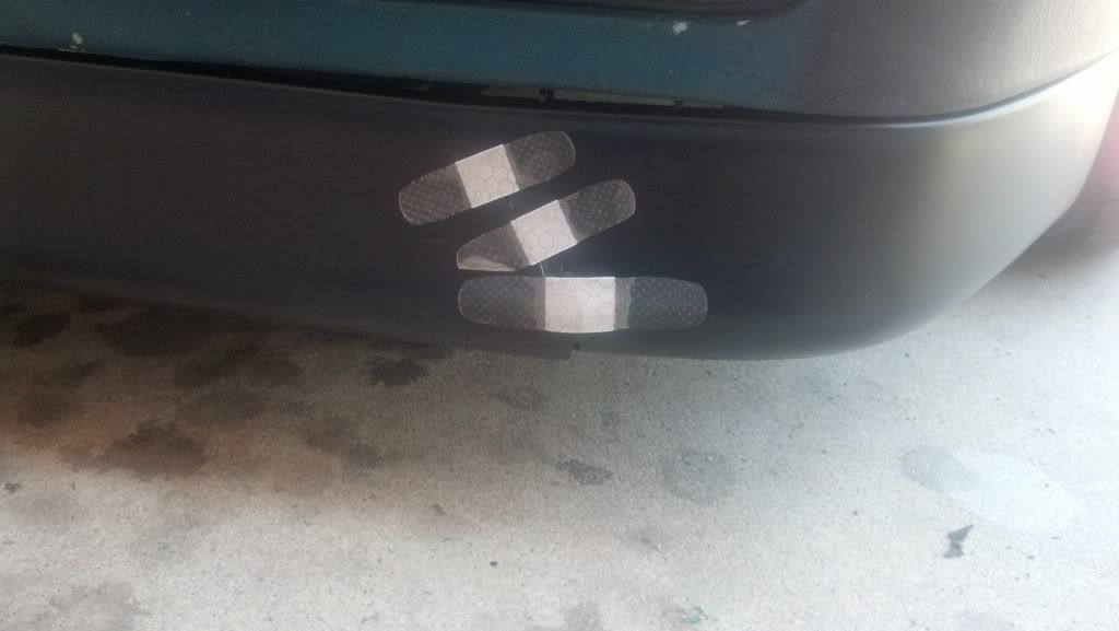

    Filling with plastic epoxy.

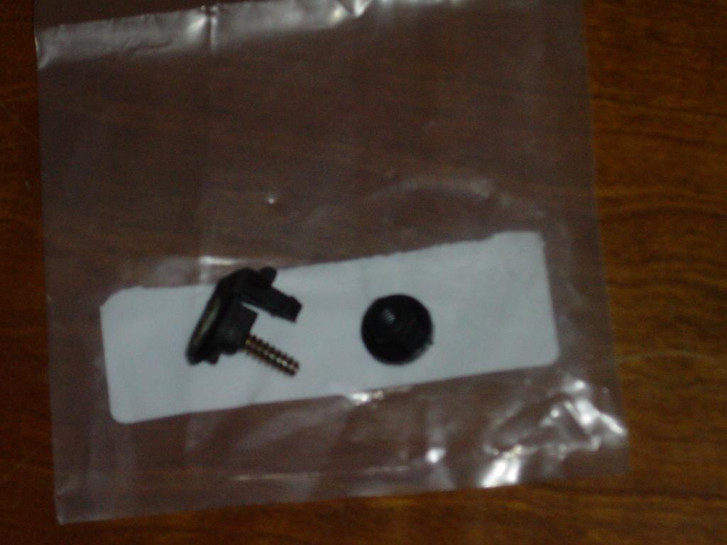

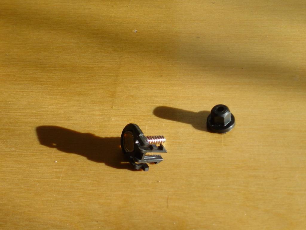

    Did you have any trouble with these bolts / clips at the fenderwell each side? These are the OEM fasteners for that valance lip.
    It's a plastic nut, unthreaded. I assume it's supposed to act like a nylon locknut. But it takes so much torque to thread it that the rounded square head is spinning in the plastic clip.
    We may go get stainless hex bolts with a shallow head and lock nuts.

      I used strong zip ties because that's all there is really room for. You only have 1/4'' of drilling room. That hardware, would not work correctly.

            So . . . the first time I rolled out of my driveway I found out the epoxy didn't get enough penetration (ha) on the side that wasn't completely broken. Also my shocks need replacing quite soon. I may have to try parking backwards up the drive.
            I'll fix it later . . .

              I ran one of these for awhile until I smacked an errant rabbit. The plastic shatters quite easily.
