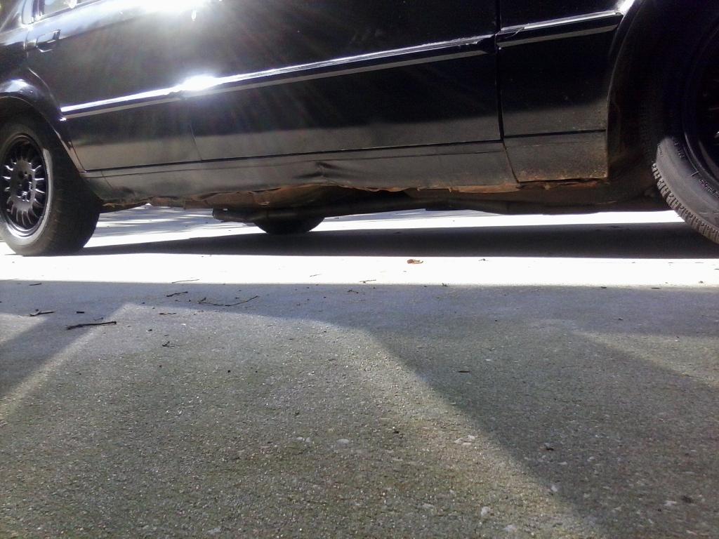

help me figure out how to fix this please?
    hey guys. this is about the most annoying thing to fix ever im sure. any ideas??? ps: po did it

    Ouch! If the metal is structurally sound, you could try pulling the dent out bit by bit with a stud welder and slide hammer. If it's pretty rusty and not worth straightening you might want to replace the outer rocker panel piece, if it's still available.

      Well the car is almost totally rust free, so it should be ok I think. Is that hard? I've never tried it

        Actually, I just found some new rocker panels for $50 total both sides. How would you go about detaching and installing?

          Cut and weld. Needs to be done by a professional.

            I have a friend that's professional. I'll get him 2 do it
              Sent from my C5155 using Tapatalk
              that looks pretty rusty to me....

                Its not actually rusty, just dirty right now
