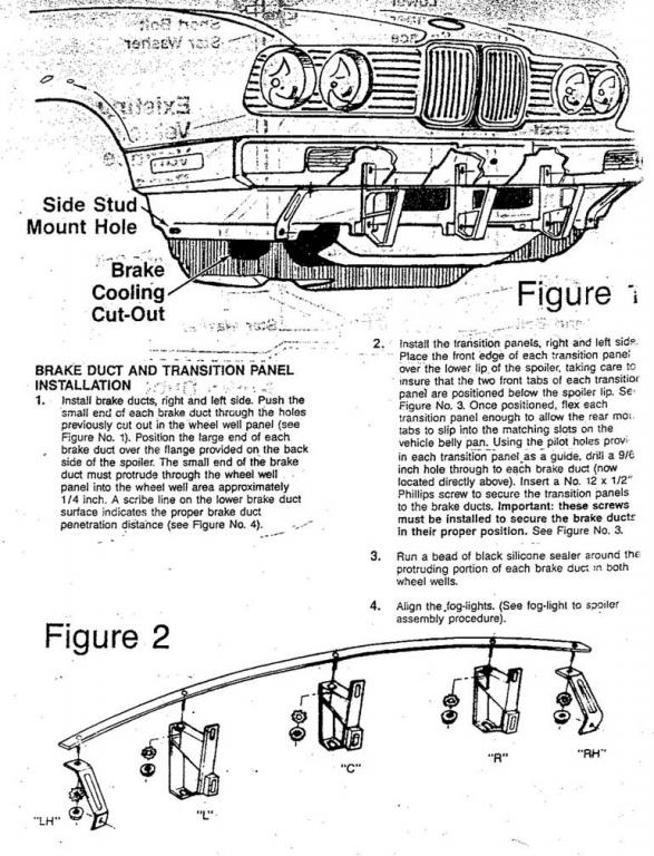

        It could be the three brackets behind it have a small chunk broken out. They're designed to give a little bit and save the spoiler if you hit a curb.
        Here are all the bits behind there...
Name:	E30 spoiler frame.jpg
            ..and they're NLA.
