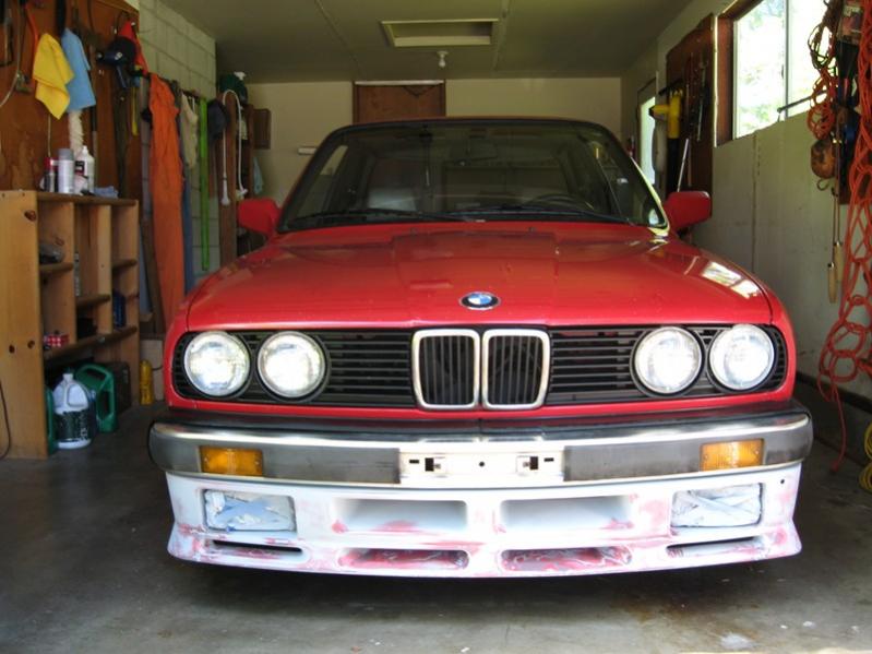

    Hey guys,
    I bought an is airdam in pretty rough condition, but for only $10. Red will obviously not match with bronzit so I'm wondering how to go about painting.
    You'll notice the paint is cracked and chip in lots of places
    It's also pitted in some spots
    So I guess my first question is, How do i remove all the paint? I tried wetsanding, but as far as that goes, it seemed to just smooth out the paint a little. Wetsanding won't fix the chipping paint. I then tried an orbital sander, it worked but I'm not going to be able to reach all the tight corners.
    Would paint stripper work? One that is safe for plastic of course. Any other ideas?
    And I didn't grab any pictures, but I picked up a rear skirt too, made from fiberglass. I need to strip that paint too and fix a couple cracks on it. Suggestions?

            So the airdam was cracked in a two places, one on the top and on the back mounting spot. I compressed the top one, and put suger glue in the crack then put baking soda over it. It worked awesome and is pretty solid now. The back is healed too.
            Sanding is working, but i need to keep going. Every once in a while I'd spray some primer down just to see what it looks like with paint over it, and in case i start sanding too much into the plastic.
            You can see the super glue line on the top of the picture below:

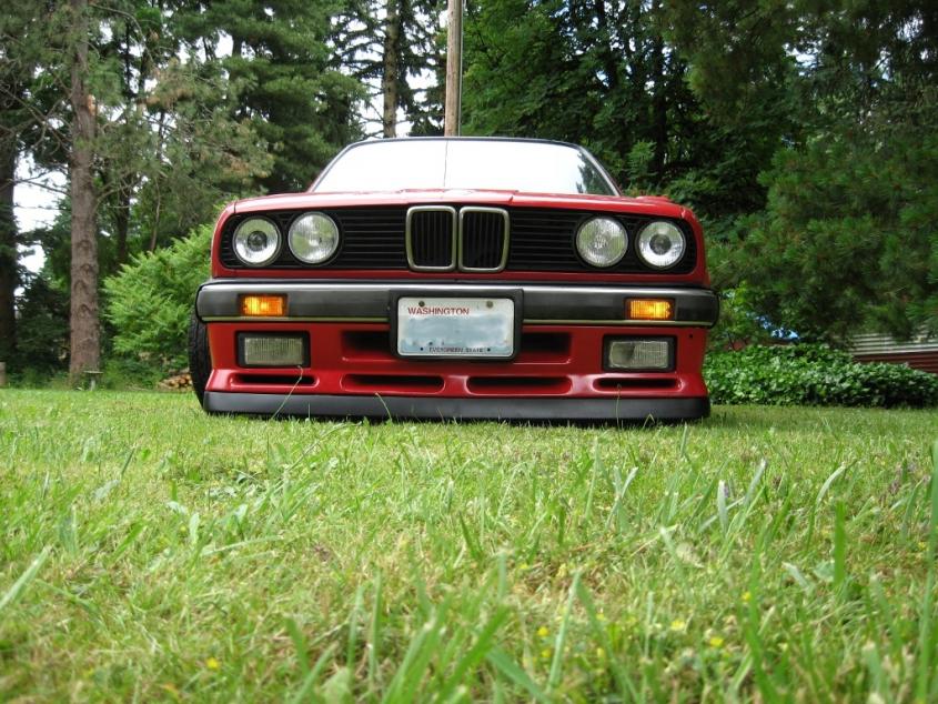

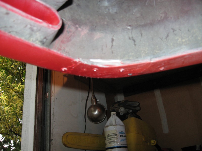

                IS airdam
                Here's what mine looked like,
                with the valance off the car,sanded by hand with 80 grit to remove paint, primer and sand with 100.
                Primer and sand with 200 and so on until you are satisfied with results.
                Painted with Duplicolor and clear.
                Repairs were made with aluminum stock, JB weld and pop rivets.
                Super glue isn't going to get the job done.
                Hope this helps.

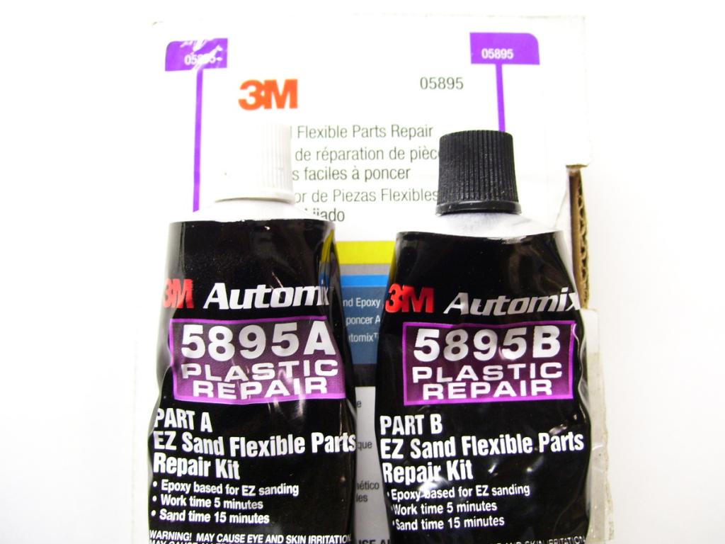

                      3M EZ Sand Flexible Parts Repair (05895) 2 part Epoxy.
