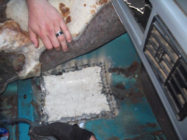

      For me, it actually worked quite well.
      I used a simple Lincoln flux core welder with minimal adjustments.
      The trick is to tack it randomly to reduce warpage. Low heat and quick tacks will do the trick.
      This is the floorboard of a Cherokee. I used a piece of an e30 body panel for material for the patch.
      I actually let my son, who has very minimal experience do the work as a learning experience, and he did quite well...
