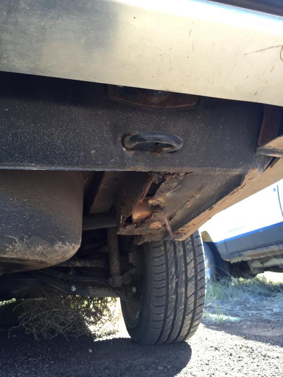

Frame rail rust

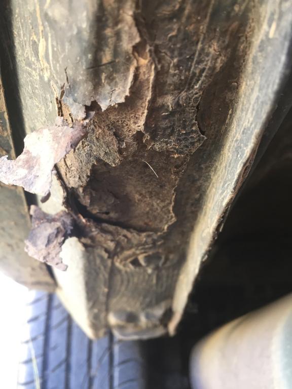

    These are not frame rails. Those are your trunk side pockets. Passenger side used for battery and drivers side is storage for the factory jack. These are typically cut out and have new material welded in. Not structural, but will allow moisture and other debris to get into your trunk.
