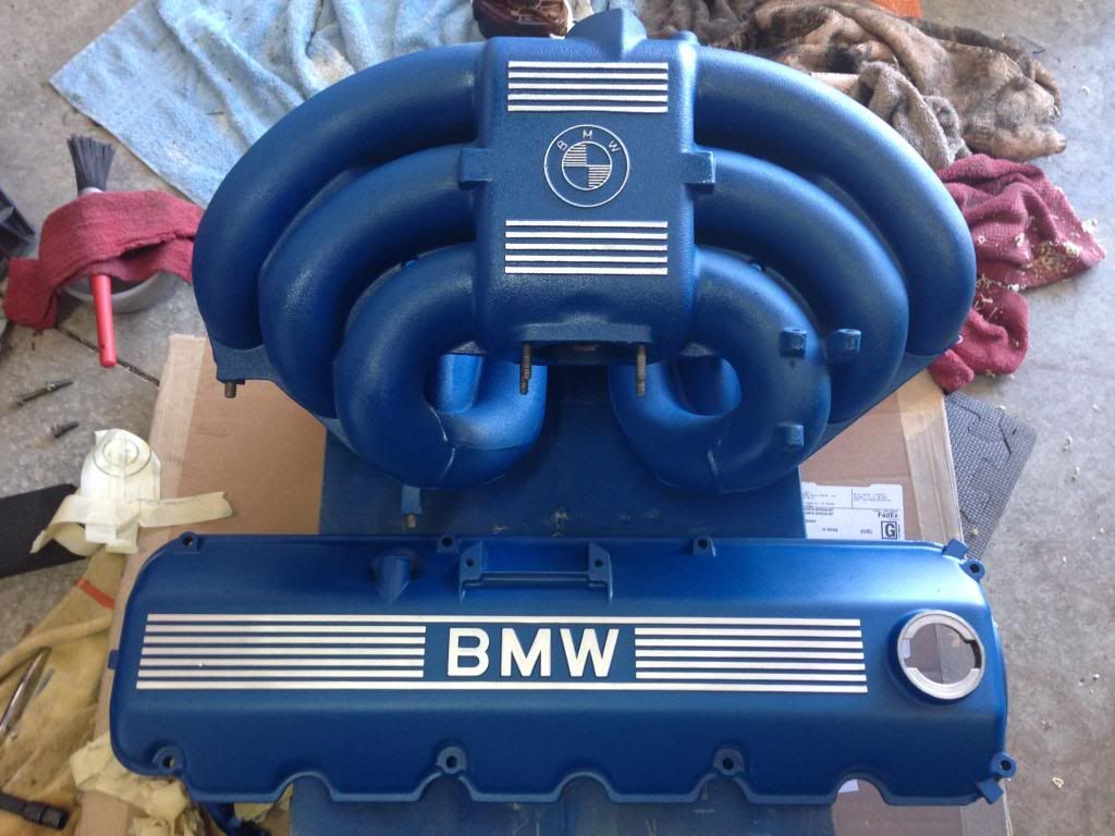

    Wanting to paint my m42 valve cover due to the fact its never been touched and is pretty rough. Attached is a picture of what i'm going for. What is the best way to go about this? Should I do it myself or take it to a shop to be powder coated? Any input is appreciated!

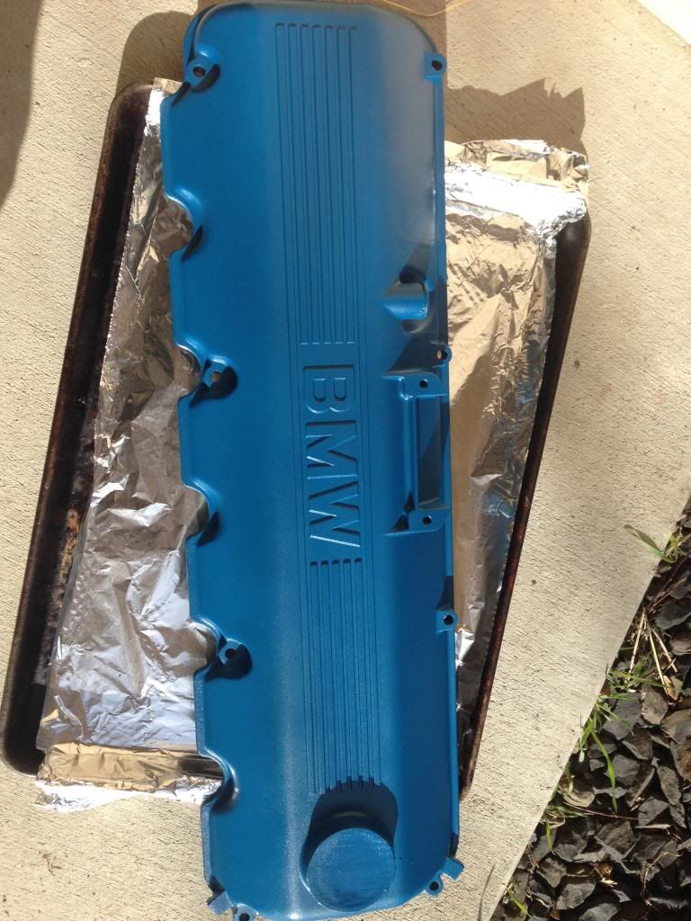

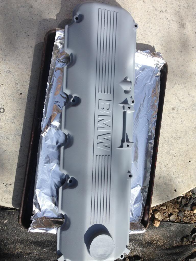

                  I used this guide http://www.pelicanparts.com/bmw/tech...ver_on_BMW.htm as a reference for painting my m20 valve cover.
                  I used VHT engine enamel I think. It's a good heat proof paint, and I really enjoyed the matt finish it produced. Basically, after each coat of primer and paint, I threw it in the oven to cure for 10 minutes. After it cured for a couple days after, I sanded off the stripes and it was good to go!
                  It's been about a year since I did this, and the paint is still holding up really well!
