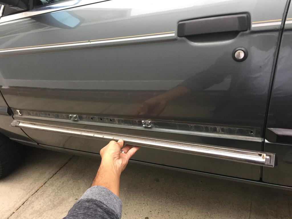

    I'm a little confused as to what clips go where when installing side trim. I have had mine off for a while so I can't remember certain details.
    I am wondering what goes in the largest whole in the front fender trim section. This hole is larger than any other holes on the trim section
    Also, In the middle of the door there is this clip remaining from the old trim, but I am wondering what goes in the small holes on either side
    and I am wondering what clip goes here. I thought this was supposed to have threads so you could bolt it in from the door jam. (this is the rear of the door) (coupe)

    The cone shaped clip in your last picture goes into the grommet in the first picture. There should be 2 per fender. Nothing goes in the big hole or the 2 smaller ones around the clip in second picture afaik. For the third picture it looks like thats the door which there should be a stud at the end of the trim that goes through that hole and you tighten it with a plastic nut from the inside.

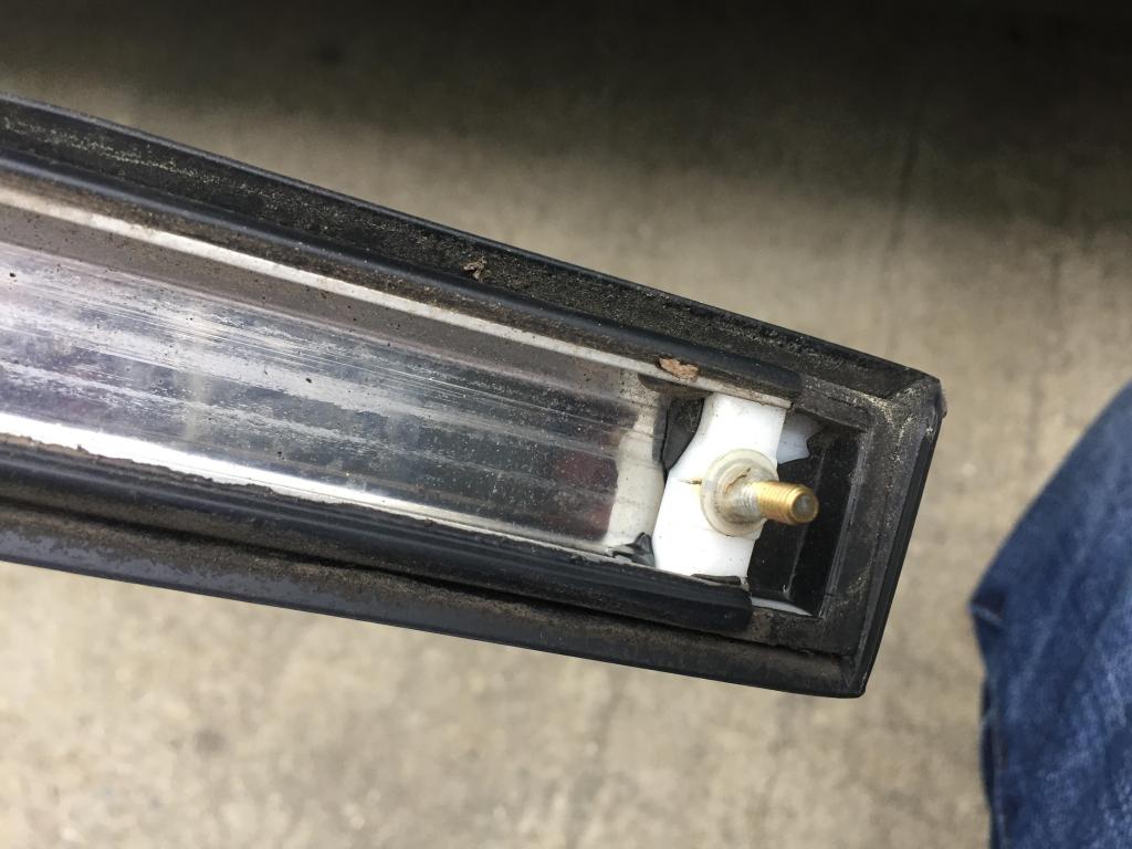

      I need some assistance in identifying the clip on the back end of the door moulding/trim...
      It is the one which has the threaded bolt which is tightened with a cap on the inside of the car...
      I found the rest on ebay... but cannot find this one.

          so i found out that its a one piece deal... need to buy the entire side moulding.
