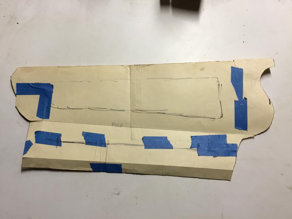

          I had significant rust on the right rear of my car, requiring me to replace the lower quarter, part of the rear valance, part of the inner/outer wheel well and truck trim panel. Since the trunk trim panel is NLA it needs to be fabricate. First step is to create a template.

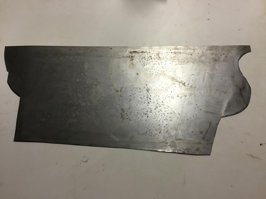

            Next transfer outline to sheet metal. The trim panel is approximately 22 ga, but is stamped to add stiffness. If you can’t add beads to stiffen, 20 ga might be a better choice.

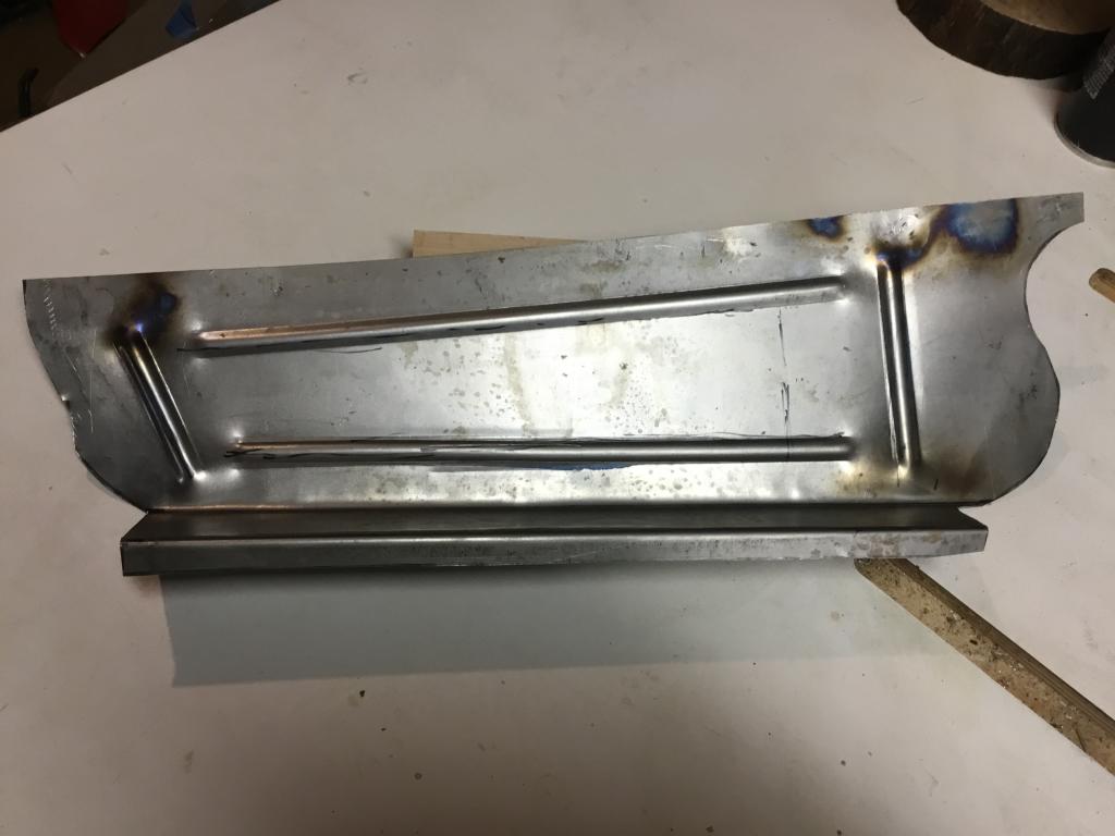

              I went with 22 ga since I planned to roll some beads to add stiffness. With or without the bead this panel only requires two easy 90 degree bend to produce a replacement panel. Add some hole for plug weld and epoxy prime and it can be installed.

                That looks Real F*cking good. A few weld takes and some sealer should do it.
