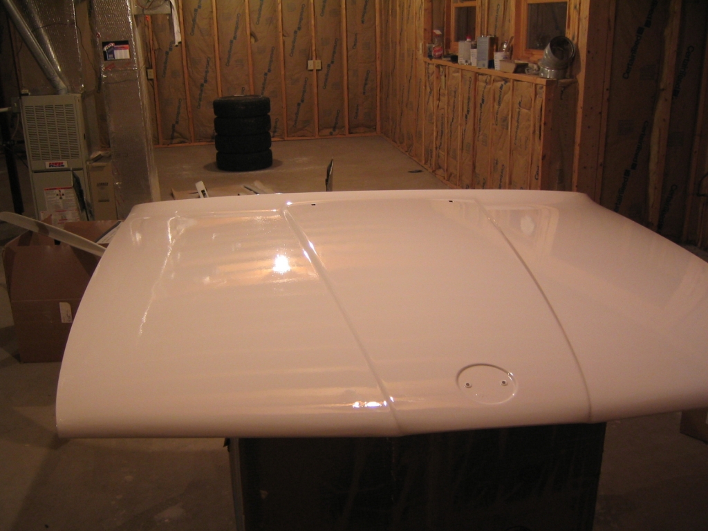

    Thanx guys, here are a few more pics (with a real camera this time)
    Took some more pics of the hood (this is with 4 out of 6 coats done). Remember, It is dry paint, NOT wet.
    Trunk lid (5 out of 6 coats completed)
    It looks better in person than in the pictures.

    from the looks of your hood, you need to thin the paint mixture more!

    Damn, that looks really good so far, Frank! Nice work, I can't wait to see more.
