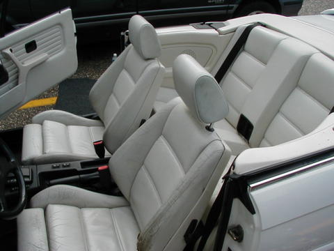

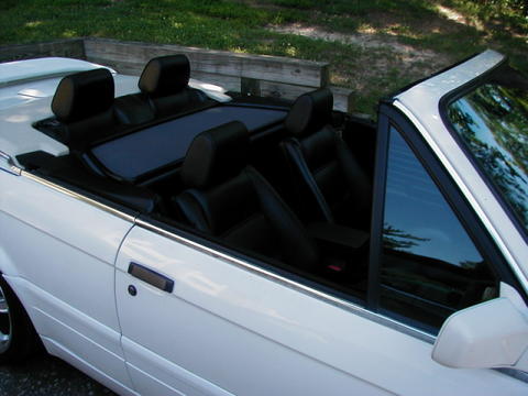

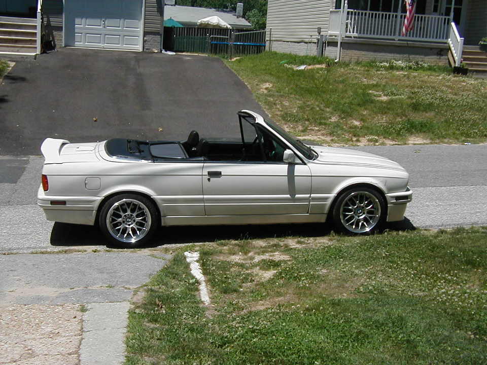

          i ran into this problem when i swapped my interior from lotus white to all black.
          anyways,i removed the whole lid cover off,masked the chrome trim and painted the vinyl section using interior vinyl paint i got from the auto parts store(pep boys)-i wiped the surface first with alcohol to prep it before i painted-so far it's,been about 4 years and it has held up pretty well-no fades or chips.
          hope this helps:-)

            Did you do the rest of the interior pieces as well?
            BTW, nice ride.
