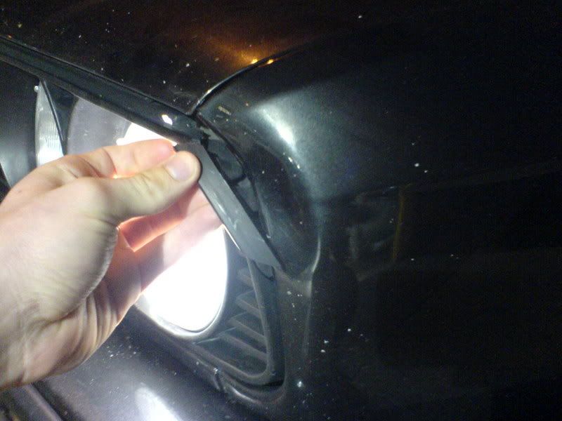

    I got into a bit of a fender-bender (literally) tonight:
    Will I be able to fix this with paintless dent removal? Or is the only way out a new fender? The guy who rear-ended me is willing to pay for however much it ends up costing, but I would rather go with the easiest/cheapest method.

    You will need a new fender. A paintless dent remover will not be able to fix that.
    -Erik

        I'm going with a new fender too. Although it can be fixed it would cost more than replacing the fender. What you want to do is get a used fender in your cars color. It should match as long as your car is the factory color and not a re-spray in a different color. Seeing that you have some stone chips a used fender will probably look better than a freshly sprayed one. It'll bolt right up except you'll have to re-do the seal by the fuse box with some seam sealer.

          That shit'll buff right out!
          yeah.
          Fender replacement time.

            I could fix that in less than an hour and get it ready for paint. Body work knowledge FTW...
