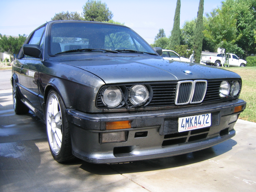

    1) correct
    2) you'll use a EURO valence with integrated fog lights, see enclosed pic.
    early US valences are cut all the way around the corners/below the bumper, that would look awful when thinner Euro bumper are installed, they actually look awful with Plastics as well., late valence should look good, you'll have to trim tow hooks for it to fit., well., let me correct this...
    Euro bumpers are too thin to fill in gap on late style valences as plastic bumpers are way way fatter.
    3) there's after market rear aprons by various tuners for euro bumpers, look at e30 euro sites for pics.
    4) AFAIK, kits from ebay, actually there was a seller based in Socal that had MT2 kits for early e30's, think it sold out. look them up or ask in the general forums.
    5) yes, sir. MT1 for early e30's. that's the way to go.
    shipping such kit from Europe will cost you from 800 to 1100 buckaroos, not counting actual cost of parts. i done it a few times., group buy will be your best bet if you want to save some moola, 3 kits will cost about $ 14oo in shipping, divide it and $ 466 a kit is not a bad freight cost.
    if you want an mt1, then let me know, including euro bumpers and what nots, side skirts, etc it will be around $ 1,700 to 1,800 at your door, euro has gone up a whole bunch. a bit more if you want the MT1 rear spoiler too, probly 2 g's in all.
    I do have an MT1 kit here in the states, front it's on Delpi 325iC, rear is in storage. Zender or BBS or side skirts and e28 mt1 rear spoiler. won't let it go for unless there's a good offer.

            uhm, when i installed my MT1 i had to cut the US early valence, only section i used was the piece/lip that sits just below the headlights/grills aka gap to euro bumper., otherwise took everything else off.
            never try to install the Euro valance/bumper i sold Smooth, so can tell it it will fit behind the mt1. good point.
            I can say that the fog's must mount to the mt1 and not the euro valence., so, it's a conundrum, lets ask Smooth.
