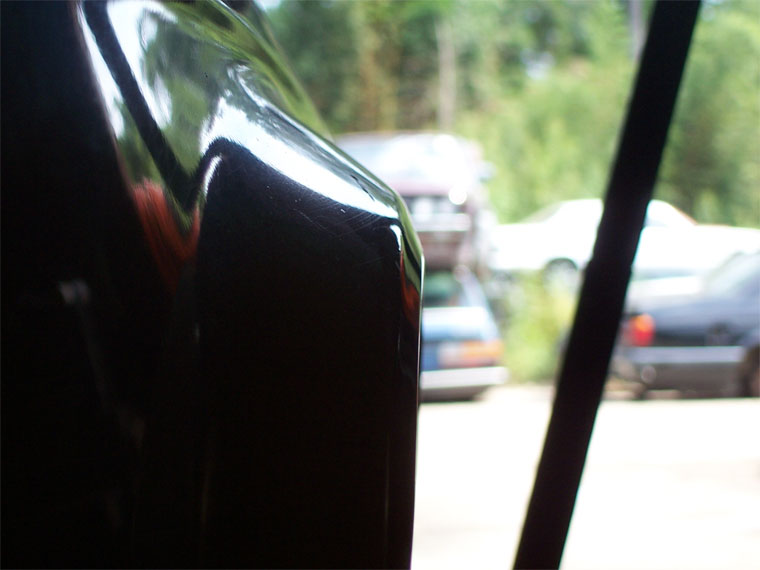

                Yea, I found somebody local that let me use it for like 20 bucks.
                This is what I ended up with:
                  any problems you ran into? did the paint crack? how did it go overall, cause my buddy with a turbo MR2 has one coming soon from some forums guys...and im helping him, and he is helping me with it

                      I used a heat gun and concentrated the heat where the roller started and SLOWLY walked it across the edges before even moving the roller. I made sure that the paint was very warm. I only barely cracked the paint in one area on the passenger side front fender. Hardest part was trying to get the inner fender liners to go back to being hidden without cutting them.
