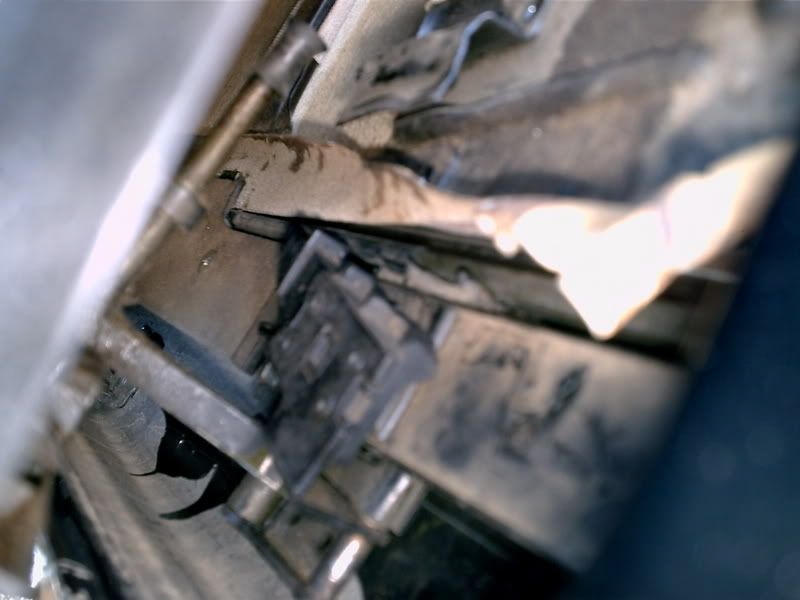

    so my sun roof is not working. it pops up good from the right side (sitting in the drivers seat) but the left is all messed up it just hangs there. and when i want the whole sun roof to open the right side will go down like if it is going to open but the left wont budge.
    heres a pic of the problem the thing that look shifted to one side was just hanging and right here on the pic is when i tried to get it where its suppose to be. anyone what it is and how to fix?
    thanks
    seems like the 2 small screws that hold that "thing in place came off somehow, thats what makes the sun roof tilt. And to fix it You'll have to take the whole sun roof apart and make sure it is not broken.
      how would i take the whole sun roof apart?
        bump
          All you need to do is tilt the sunroof then from the inside start removing the 6 torx screws (3 per side) once you have these off you should be able to remove the panel. Once the panel is removed you can see whats wrong with the rail from the top. But from what i see in your pic your prolly gonna need to replace the assembly if thats the case then the plot thickens.
