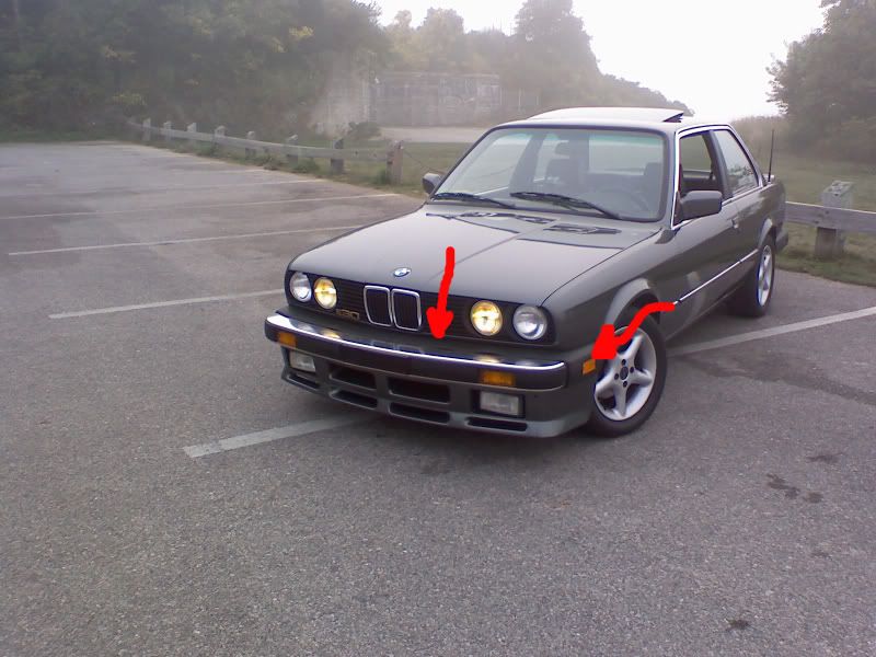

                Outside... And i'm guessing the valance looks like this?

                      Yes, it is gorgeous.
