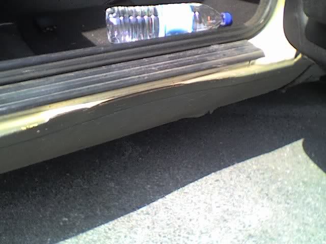

    how much would it cost to have a body shop or someone repair these issues? the car has some problems but everything else can be fixed/replaced by myself except these...
    lower panel by passenger door
    lower kicker under passenger door

    Labor to fix, in hours. Multiply by labor rate in your area (mine is $44-$46). This does not include painting which is generally 2.5-3.5 per panel.
    Photo 1: quarter panel 3-4 hrs, door at least 4 (cannot see where damage ends)

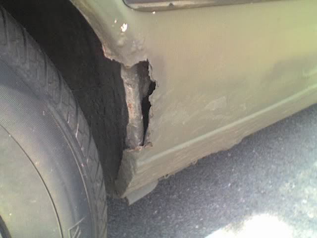

    Photo 2: 5-6 hrs

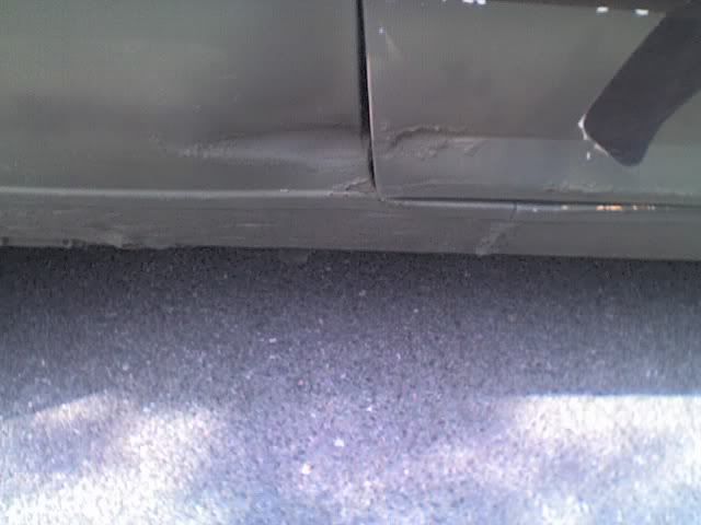

    Photo 3: at least 8. That requires a patch panel to be made and welded in. Could easily be double, and then the wheelhouse may need some fab work as well.
    I would not spend my hard earned money fixing that car. You are better off buying a nicer shell for what it will cost to repair what you've shown. Rusty cars are a WASTE OF TIME AND MONEY. Do not 'restore' one. These are not vintage Duesenbergs. You'll never get your money back. Rust never sleeps either.

      the door i will just be replacing once i find one at a salvage yard since that route will be much cheaper.
      the car isn't in bad shape other than these issues, if i can find a way to fix the last piece i will be set... haha.

        i got the exact same problem, with that rear wheel spot, i was gonna decide between two options, 1st would be to weld a piece of metal in there and make it look as best as i can and then use some body filler to help get it even closer, or just use a grinder and get rid of as much rust as possible, then use a rust inhibitor and bondo the whole thing, either way it will work im assuming for a couple years, and i dont plan on keeping the car for another 10-15 so something that will last a few more years will suffice for me.

          I would deff scrap or part what you can off of it and find a cleaner body to start with, you will be happy you did in the end. A roller can be had super cheap...I've had 2 in two years both free & parted/scrapped. locally they give anywhere from $100-400 for a scrap car depending on weight. I am always willing to except that inconvience of a car/truck/van etc..that people have to get out of their yard = E30 mOd $$$...
          You can get a better peek at that quater damage by pulling the interior panel off. I found one of my cars had a good amount of rust that had came through ...IE lost cause...unless your willing to shell $$$ and time to fix something that can easily and prob cheaper to just replace..
          Good luck if you decide to fix it. I am not 100% for just trashing cars but you gotta make sure your being cost effective and not stupid
