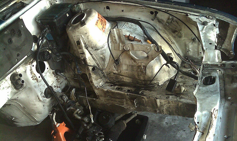

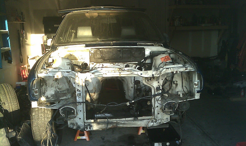

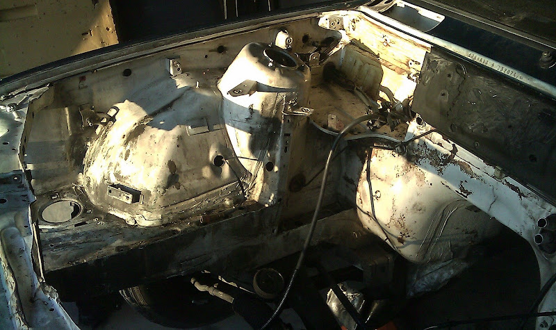

            Here is mine so far (as of this afternoon)
            I removed everything possible as the M50 going in is going to be a very minimalistic swap...
            Here is the front view, the body harness is just strung there to keep it off the floor (I have a little repair to do there...)
            Here is the drivers side. All that is left is one hard line (passenger side brakes) and the wiring.
            Here is the passenger side. All that is left is that power distribution box thing.

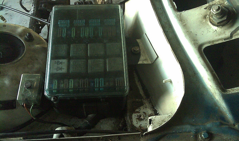

            Here is the fuse box. If you completely disconnect the body harness from everything and unscrew that bolt that connects the fuse box to the firewall, you can flop it forward a good bit. I plan on doing that to get at least a ghetto coat of paint behind it.
