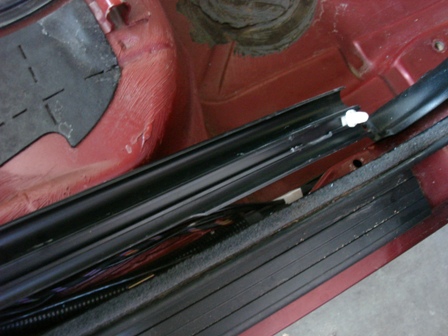

    It's hard not to break the clips. If you break them, just order new ones..I broke about 3, but they are still fit tight against the carpet..

      When I broke a couple of those off, I just went to the junk yard and grabbed a handful of them from a couple of cars there. Replaced then ones I broke, plus I have extras in case I break them again.
      I did find that after I broke a couple of clips on one side, when I did the other side, it helped to do it slowly, one section at a time, prying up with a flat blade screwdriver in between the metal and plastic. Didn't end up breaking any doing it this way.

        If they are original they will break for sure. New ones are $12-18 iirc each. Clips most likely will get mangled as well, so order a new set, those are cheap.
        Sheet metal screws? - Uhh no. Put it back in the same way.

          picture of what you broke? i plan to replace my doors and swap over the internal parts so i wanna see what to look out for and possibly order before i do it.

            The door molding is different from this door sills..

              One of the 4 molding pieces I am talking about is shown below. You can see the plastic clip (white) that slides into the molding and then flips over and snaps into the body of the car.
Name:	bmw floor molding3.jpg

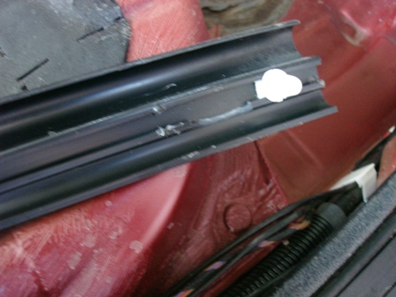

              I did not have trouble with the plastic clip breaking, rather the molding itself broke before the clip broke, as shown below.
Name:	bmw floor molding4.jpg
              I tried to use a screwdriver as suggested above and slowly pry the piece off, but the molding still broke. Maybe I just was not slow and patient enough.
              There are not many BMW's in junk yards in Minnesota, so I can't get the molding and clips there. I suppose the dealer wants big $$ for them, or are the molding pieces just about $15 as Jean said above?
              'm not sure what I am going to do now. Maybe I will just have to get some black headed metal screws and screw the molding directly to the body, unless anyone has a better idea. Maybe I could epoxy and screw the clips back on the the proper location, but they would break for sure if I ever tried to take them out again.

                realoem.com shows sill strips for ~$30.

                  clips break... old plastics are brittle no matter what you do, just go to the yard and grab a handful. Even if you do it perfectly, it will still break.

                    Thats exactly what I thought you were doing, I just recently replaced mine. They get brittle with age, so I would say one time use only LOL.
                    When I got the new sills and clips, I slid the clips over from one end and then lined them all up to make sure they all would go in the holes .
